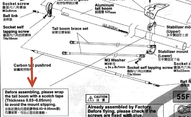

      For some added protection you can do this:
      There's no way the boom can slide out if the stab mount can't slide and it can save a bent boom in a crash, as well.

      I just finished pulling it back apart, and putting some tape on it. That you, @beenflying for the tip. :)
