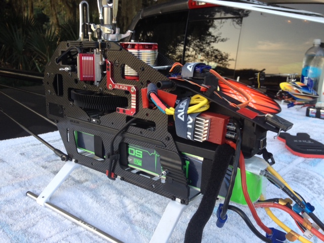

    3. feral
      This is how my 700 and 800 is rigged up $4 fan off ebay with a servo plug soldered onto the end I also would run a cc160 with the 800mx it will help with cooling aswell
      I only really need to plug it in around Christmas time as it reaches nearly 40 out my way.
      Congrats on your move to Aus mate

      What motor is that?
    5. feral
      In the pic @Min ?
    6. Min
      Min Well-Known Member
      324
      249
      Yeah, looks like a pyro but it's a different red
    7. feral
      850mx Align donk bro

      Thanks Feral for the info might have to get one of those.Have you had any issues with the setup at all in regards to power?
    9. feral
      If you fly hard you will find the over current cut off with the 120a even when its set to insensitive it will cut
    10. feral
      Average amp draw on the 850mx and castle 160 is 97a with peaks of 190+amps on the 800 pro
      The 800mx is capable of producing serious power id be putting a 160 in it regardless

    12. Manyc
      With the 800mx I used to over heat the 120 in summer... I switched to a 160 with the fan... been fine every since...
