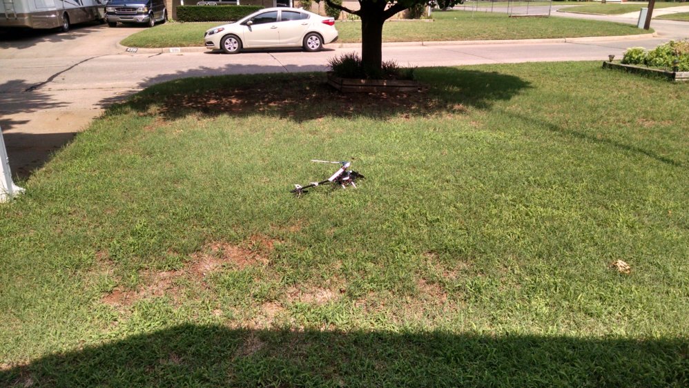

      FBL conversion complete on this $100 used Blade 450-3D. CopterX FBL head and K-Bar FBL controller.
      This was actually 3rd attempt at test flight, as the first two attempts ended with tail blades being flung-off on spool up.

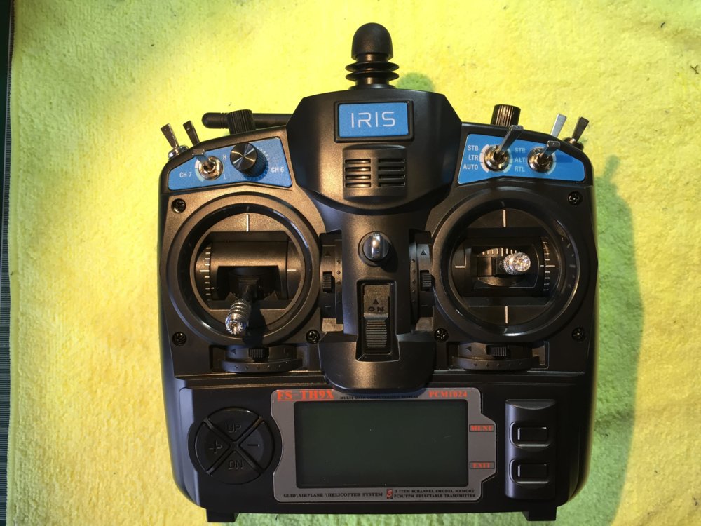

      I finally decided to get a better radio.... image.jpg FS-TH9X 9-channel computerized radio. For $59 shipped, I couldn't pass it up. I'll need to convert to DSMX, but I'm going to forego the Orange module and use the DSMX module out of my DX4e. It's a reasonably easy conversion from what I read, and it's a popular mod.
      9 channels will allow more control over K-Bar parameters "on the fly" and possibly a few other functions. Model memory, throttle curves, timer, and all the good bells and whistles. :D:D

    18. Beaver
      The surgery was a success! Resident protocol of the TH9X is now DSM2 (I couldn't bring myself to part the DSMX module out of the DX4E just yet).
      I'm very fortunate that the particular radio I bought already has the upgraded firmware in it for DSM2/X selectivity. No firmware flashing needed! Using the HP6DSM module and antenna, you cant tell anything has been done to the radio except the empty module socket in back of the radio.
      The first setup was tested on the little mSRx. After some fumbling through the menu to find the servo reversals for ailieron, I managed a quick flight.
      The mSRx flies like a totally different Heli with rates at 100%! Now to program in the rest of the fleet..... including the B450-3D in original flybar configuration. :D:D
