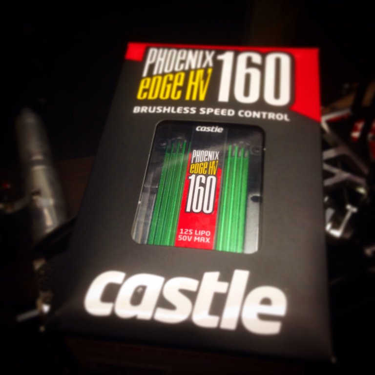

    Wow I would just like to say thanks to Castle for a very speedy return of my 160HV
    It was shutting down on me in flight and tunes out that data board was coming unplugged from the main Board. It only took two weeks. Can't wait to strap it back into my E7se, worked great when it was working.

      I think that problem was raised about a year and a half ago castle raised the alarm
      and you could do a mod with a bit of sticky sponge tape and all good I think they would send you some tape for the job.

      Yeah dude, I tried to fix it but wasn't working. Even tried a different data board from James's crashed ESC but still didn't work. I love the Castle Creation ESC's and the computer software is awesome so can't wait to get it bolted back on.
