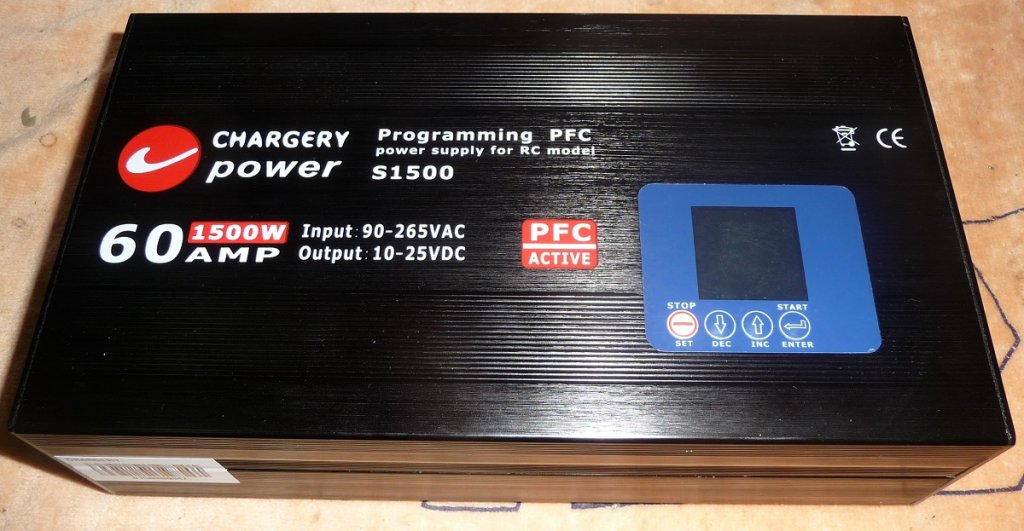

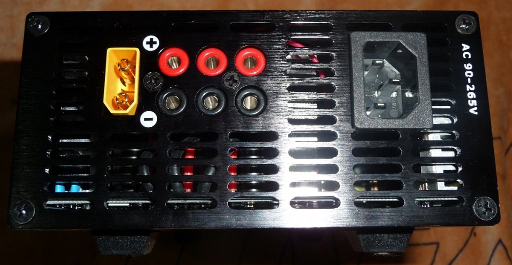

    Chargery (www.chargery.com) make a range of power supplies with a 2 year warranty and the 1500W one looks pretty good so I order one for USD$350 delivered direct from the manufacturer as there's no distributor in Australia. I picked the 1500W because I'm not a fan of running stuff at the limit. I could have picked the 1200W one, but bugger it I liked the display version and the XT90 output jack. I just cut the banana plugs off the charger cable & added a XT90 plug rather than use the one that came with it.

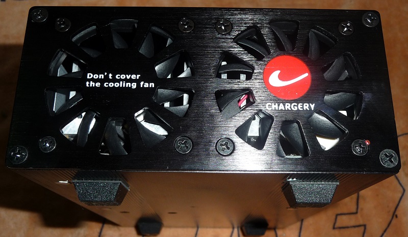

    So far I've only pulled 15A out of it fast charging two 5S packs and the fan comes on intermittently when the internal temp gets to ~45 deg C. I'm pretty impressed so far, the unit runs cool & has no dramas.

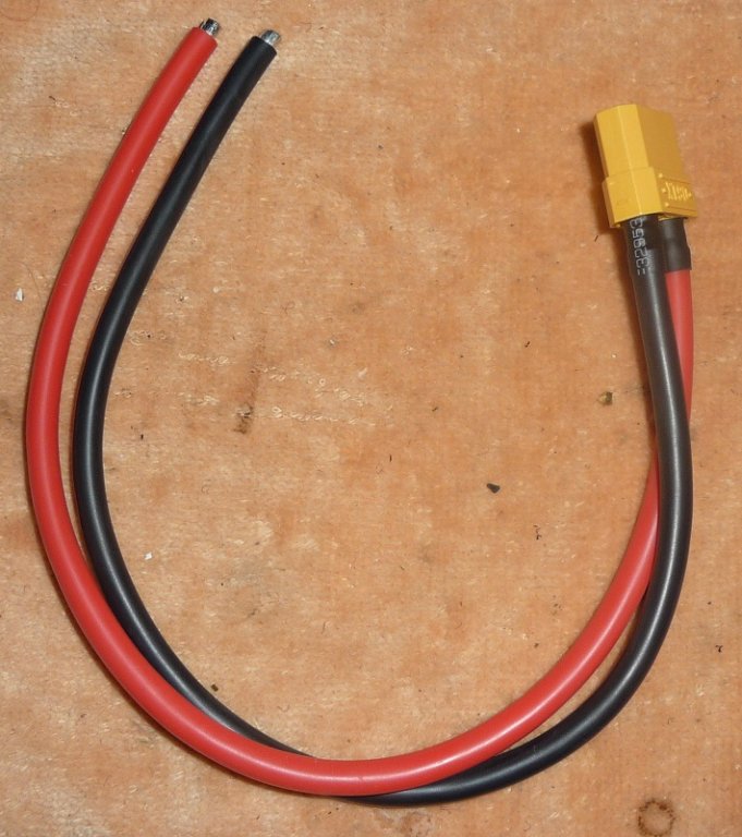

    3. XT90 output plug with cables neatly made up come in the box which is great as a 4mm banana plugs can get a bit warm pulling big amps.

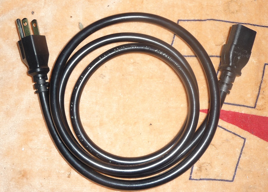

    1. Power lead supplied has a bloody American plug, so I'll be changing that.
