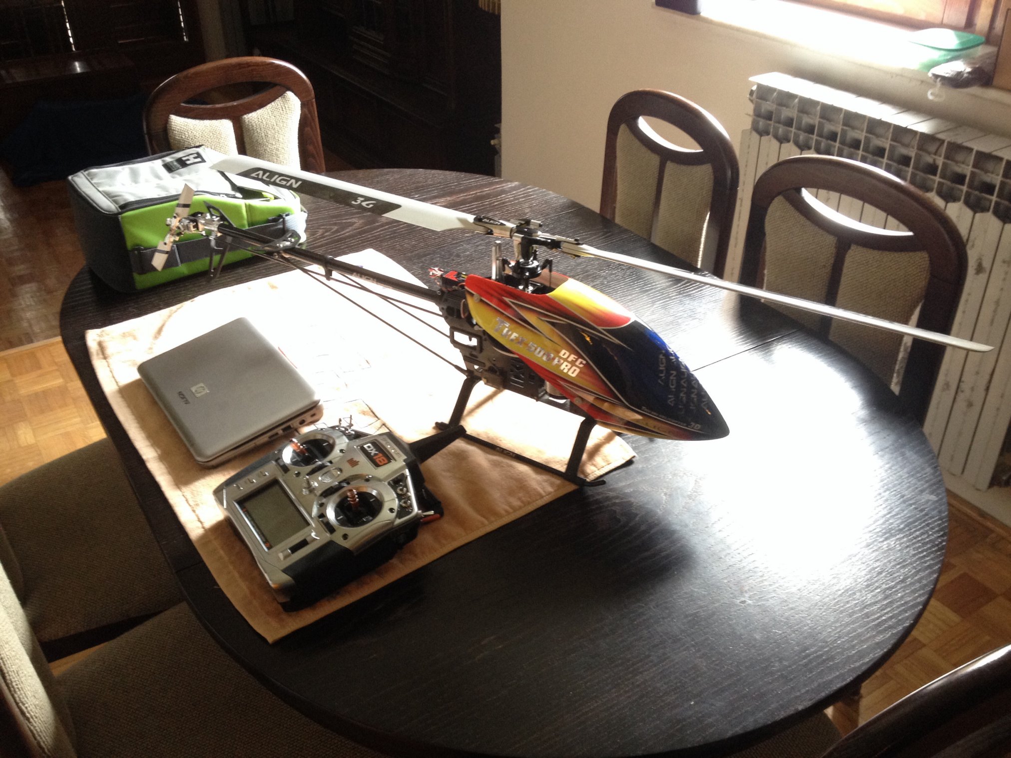

    Hi there,
    After 187 flights this season with my 500 DFC Pro I have a notable play in the DFC head. The blade holders are playing up an down a bit. At the end of the blades it tots up to about 15 mm to 20 mm.
    I know that I had no play as I have built the helicopter in April this year. Now there is maybe 0.5 mm space between the blade holders and the central head piece.
    My question is if I have to put in some spacers? Or can I ignore this issue - because the heli feels good in the air? Doeas somebody know which spacers would fit if needed?
    Thanks in advance,

      Just finished the maintenance and set up with GPro. No more head or tail play. Everythings tight and running smooth. Lets go for a test flight. :)
    10. iggy
      Test flight completed. Gpro seems not to be a bad thing. But I have a tail wag now. Tail is holding only at 100% throttle. Thats not what I want. So Back to the computer and try to set it up better. Whats more.. oh yeah - it was bad ass windy and cold out there.
