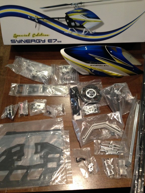

    Look what arrived at my place today!!!!

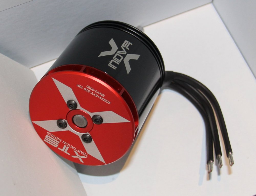

      Check this puppy out!
      Thats a very nice looking motor! It has the same part no as the scorpion 4530?
    6. MadBird
      Yep, same as the Scorp the stator is 45mm diameter and 30mm thick. Other specs are very similar to Scorp too, but the XTS is rated at 5.1kW continuous instead of 4.8 kW and supposedly higher efficiency too. After hearing what @Dale Worthington has had to say I will need to keep collective pitch and head speed down a bit so that I don't burn through the batteries too quickly.
      I was heavily leaning towards the Scorpion 4525-520kV but I picked the Xnova up for under $400 new, so couldn't pass it up. This motor like the 4525-520 is wound in star/star or YY configuration which means not having to run the Kontronik in KSA mode either.

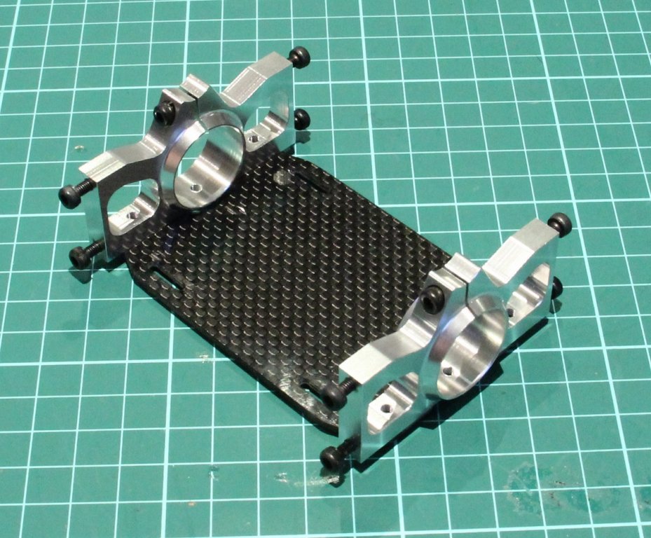

      1. Base Plate

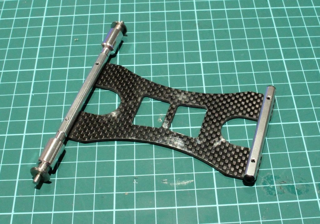

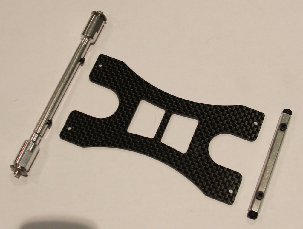

      2. Sensor Plate and Lower Frame Base
      1-Sensor Mount and Lower Frame Base Parts.jpg 1-Sensor Mount and Lower Frame Base assembled.jpg

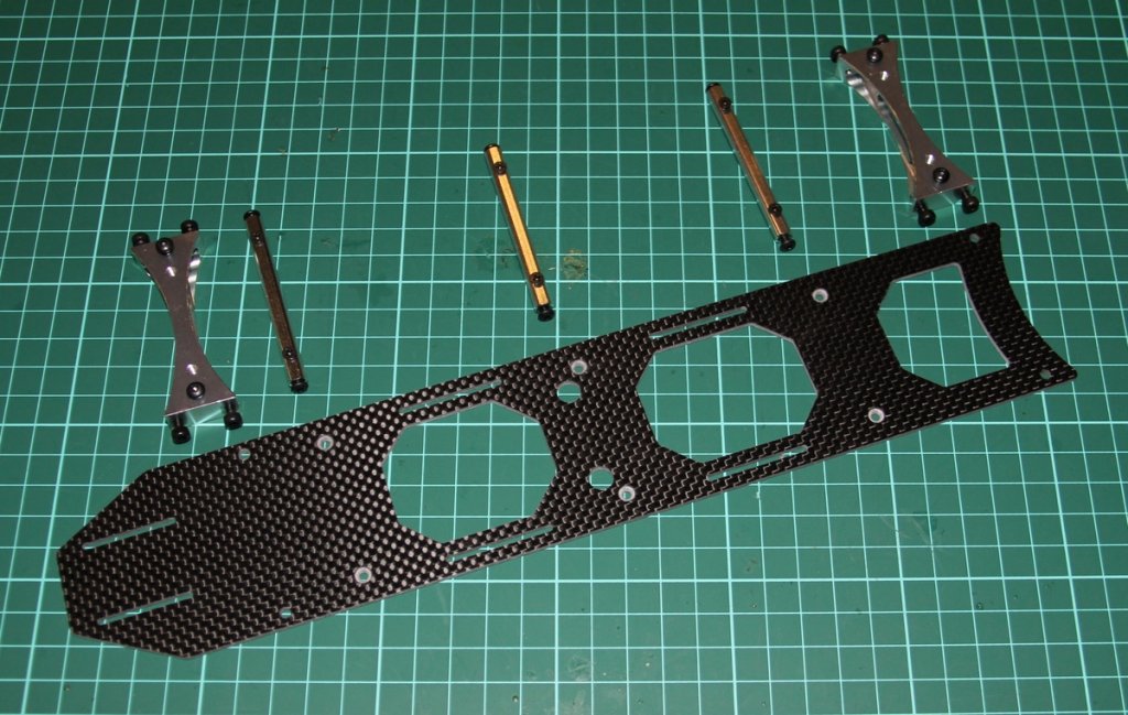

      3. ESC Mounting Plate

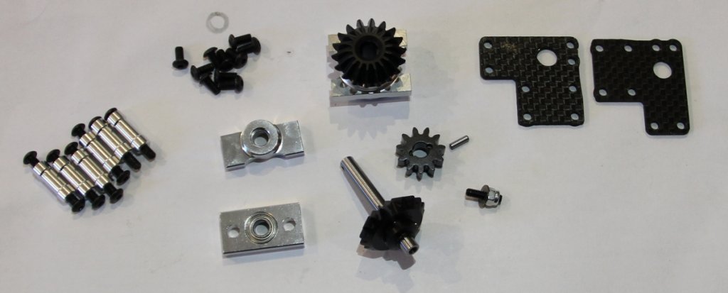

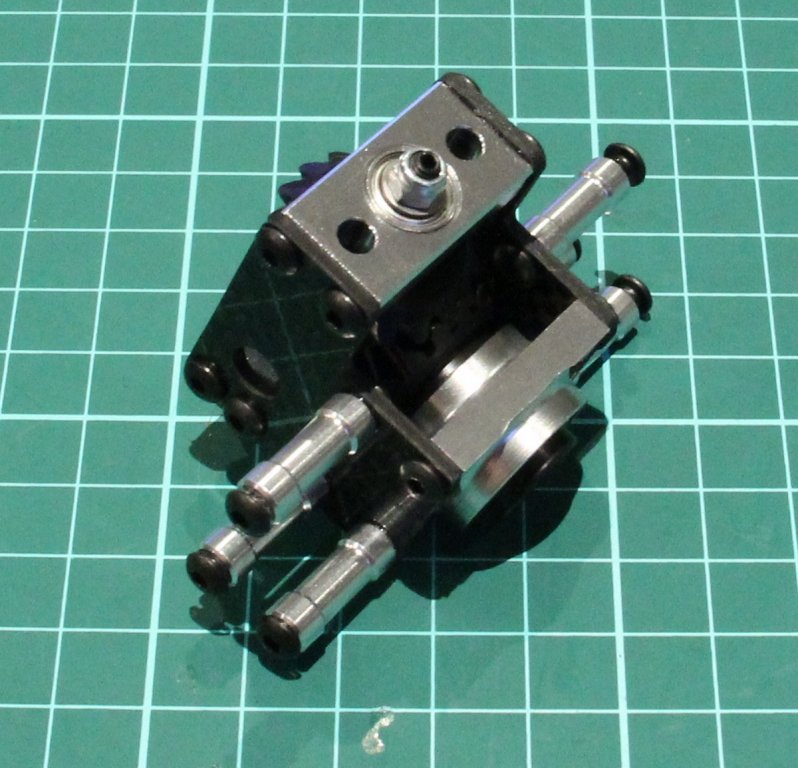

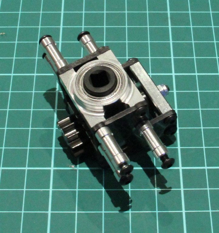

      4. Front Transmission Module
      1-Front Transmission Parts.jpg 1-Front Transmission Assembled - 1.jpg 1-Front Transmission Assembled - 2.jpg

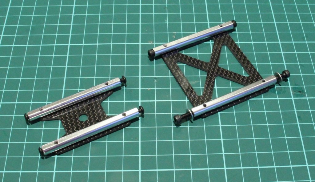

      5. Main Boom Clamp

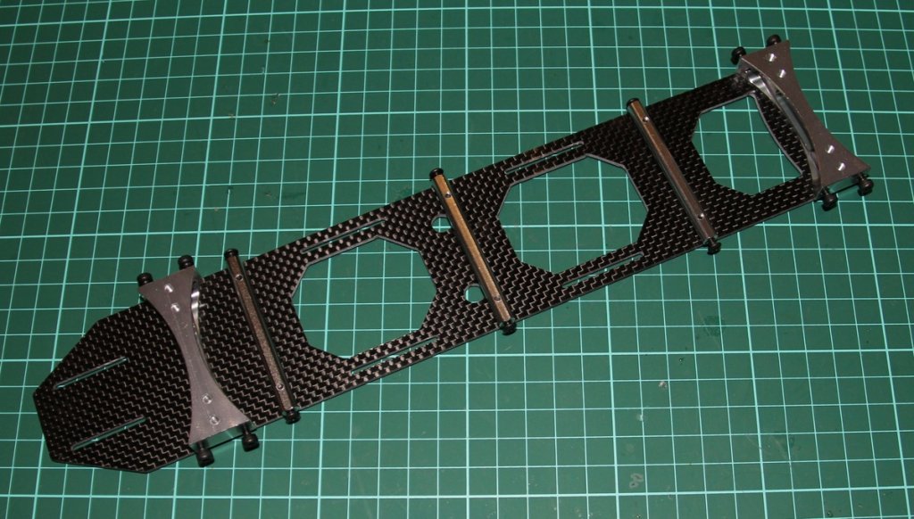

    12. MadBird

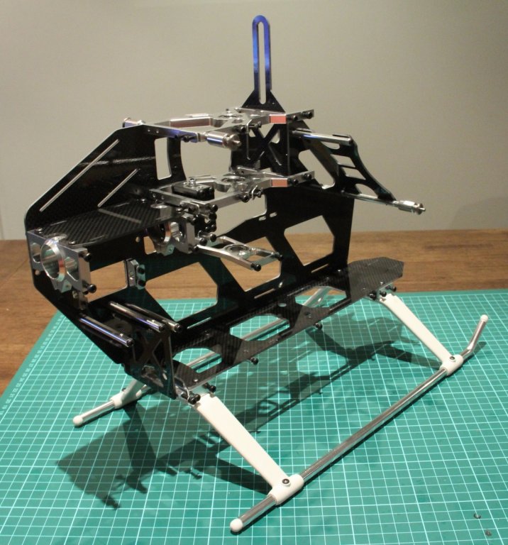

      Here is a sneak peek of half of the main frame assembly. Hopefully my rudder servo will be her tomorrow then I can install that, square it up and loctite her together.
