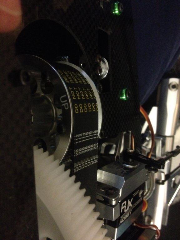

    1. iggy
      It has never been flown.. therefore Im checking everything on this helicopter. The first thing I noticed was the rear pulley. There is an "UP" written on it - And this side has been mounted DOWN!! Shouldnt the rotor spin free CLOCKWISE without moving the motor (For Autorotation)? - The manual is not very precise on this, thats why the mistake happened maybe. Or am I completely wong? Please give me some advice before I pull this thing apart. The pulley sits in the core of the heli - I have to pull everything apart.. :-/

      Great to see your return @iggy!
      If the pulley marked UP has a one way, obviously its going to free wheel (unless the old owner connected the motor in reverse - and put everything in reverse - this is possible). So i would pull the pulley off and put it the right way up - and set everything up from there.

    6. iggy
      Yeah its mounted the wrong way. I have to pull it apart.. Doesnt matter, I have time.

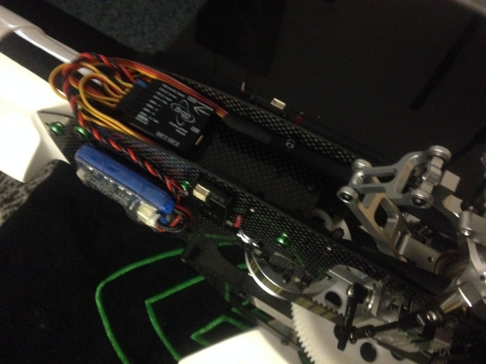

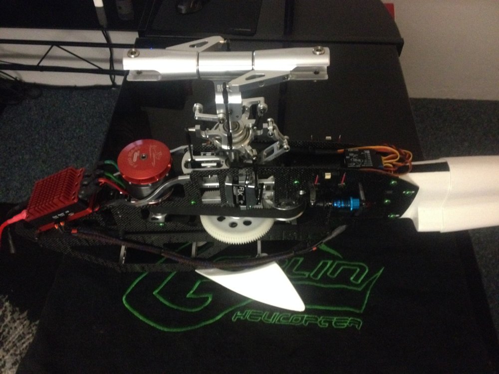

      Done some wiring in the last few hours.. :D waiting for some shorter satellite wires, a fan for the kosmik and some other parts.. I like to take time ;) have a nice day.
      Some nice gear in that helicopter. Kosmiks are awesome - set and forget. just change a mode and optimum settings right out of the box Normally. Looking very good.
    11. iggy
      Mode 4 will do it. Had a Jive in my 570. Easy to setup. I have the prog unit to setup the BEC. There is a plug in telemetry system available from IISI cockpit V2 made for Kontronik Kosmik to show Battery, RPM, ESC temperature and more. Got to order that :)
