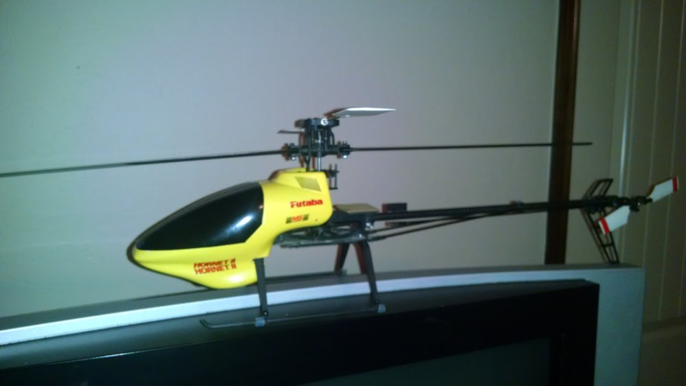

    Here's an I interesting little vintage Heli from the Czech Republic:
    MS Composit Hornet 2 - 300 size CCPM - Torque tube tail drive.
    The fly-bar head is similar to other helis of the time, complete with elongated loop flybar control links as found on Blade SR, CP, CP Pro or even the old Twister.
    It's a strange bird for certain. The frame is extremely simple and light weight in design.
    The thing was free aside from shipping, and came with a few spare parts..... no electronics, just basic airframe. IMG_20160719_244343893.jpg IMG_20160719_244709613_HDR.jpg

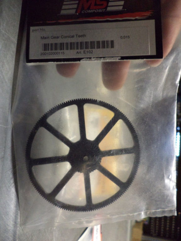

      Parts are hard to find for this old bird. I may end up mingling in some Blade CP/SR parts to complete the head assembly. I have a 4700Kv ProMax Neodymium brushed motor located already. I'm eyeing this alloy gear set with OWB... if it's still available. mt4011.jpg
      I will probably have to go cheap at first and get a stock main gear, but I dont like the odd 0.4mm pitch that looks like it would strip easily. I can't change to an Align type 0.5 pitch gear because the tail drive is built into the stock gear hub. $_3 (1).JPG
