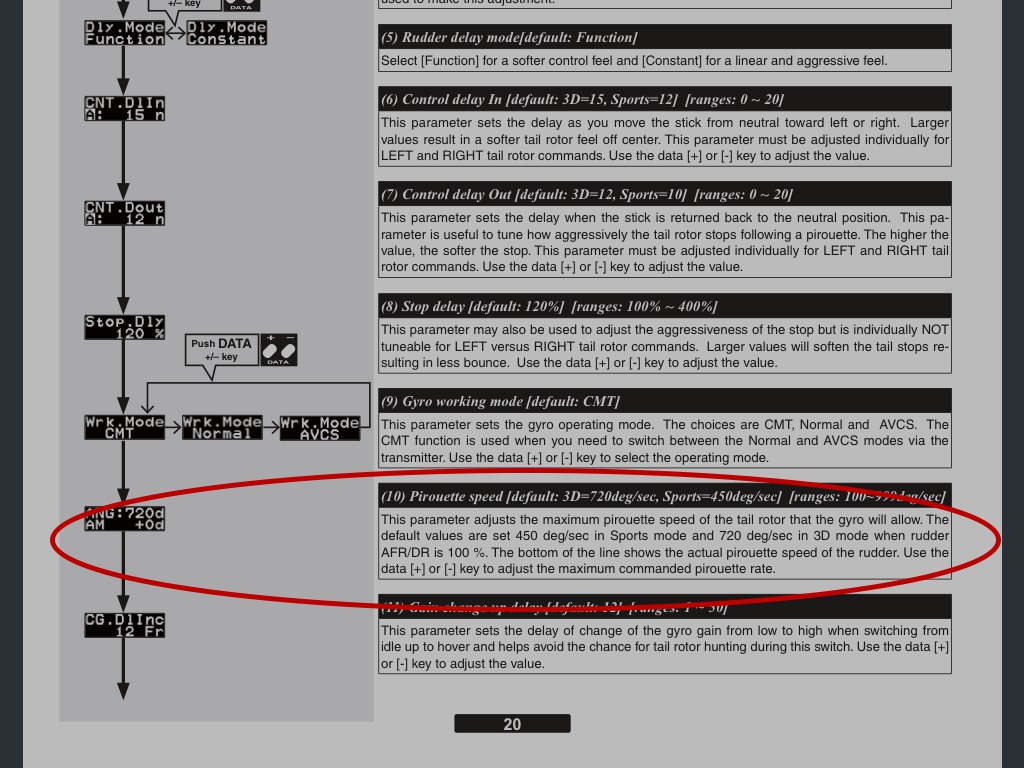

      Ok, think I have found it in the manual. Since I like the overall feel of the sports setting I'll stick with that and speed up the tail using the ANG setting in the RUD GRYO EXPERT menu.
      I'll try 600 which is more than sport but less than 3D and adjust from there.
      Yes that will work. I use 720 on the tail atm. But if you want to dampen down or increase the speed of the cyclic and the overall feel of the helicopter (roll rates etc) look no further than the flight tuning menu on page 14. You can do so much the options on flight tuning and make your heli feel very tight/robotic or loose and fluid. The CGY 750 is a great gyro once you get to know it better.

      Yeah, so many parameters to play with... For me it's keeping it simple at the moment. I find the flight feel and responsiveness of the sport mode very comfortable at the moment. My challenge came in stall turns. I wanted to piro more than once or at least get the piro rate quicker. In sport mode it was just too slow and if I did more than one piro in the stall I was loosing to much air. So I'm thinking that speeding up the tail is the go.i was also running 80% DR on the rudder channel so can also increase that to 100% as well.
      It will be a case of adjust and fly, assess and repeat until I get it where I want it. It's likely to change as I improved and become more confident with quicker resounds ex etc.
