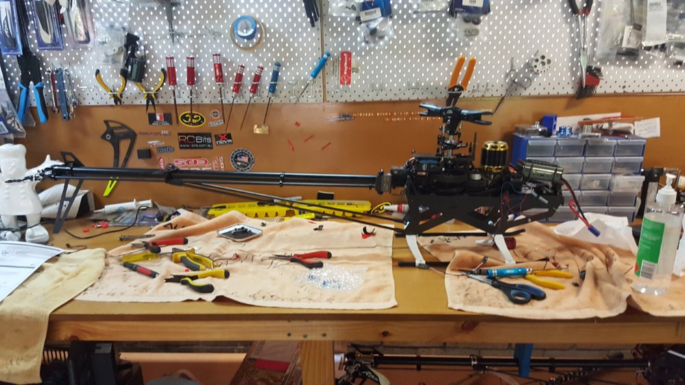

    The Kit
    Everything in the kit was packed nicely and well protected. There were no missing parts, and it takes a leaf out of Aligns book, it includes Velcro tap, zip ties etc... All the bags are labelled, and line up nicely with the manual, which makes it easy.
    The only thing to keep in mind, is that it does not come with blades or a pinion.
    The Build
    The build was simple enough, tho I did get a stumped in a spot or two, and I would say that was mainly me rather than the manual. The parts are all quality machined, and the carbon look very high quality. Not really much to say.. its a build.. enjoy...

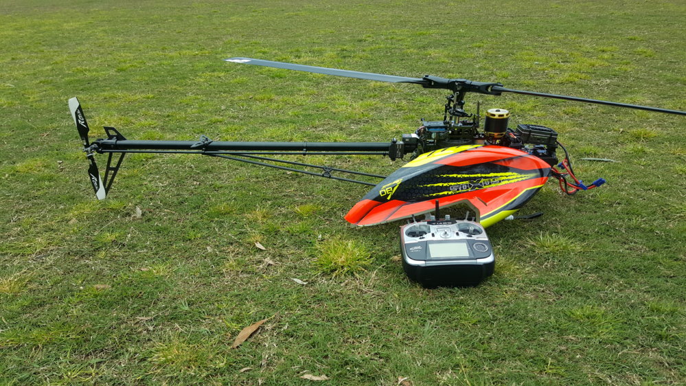

    Impressions

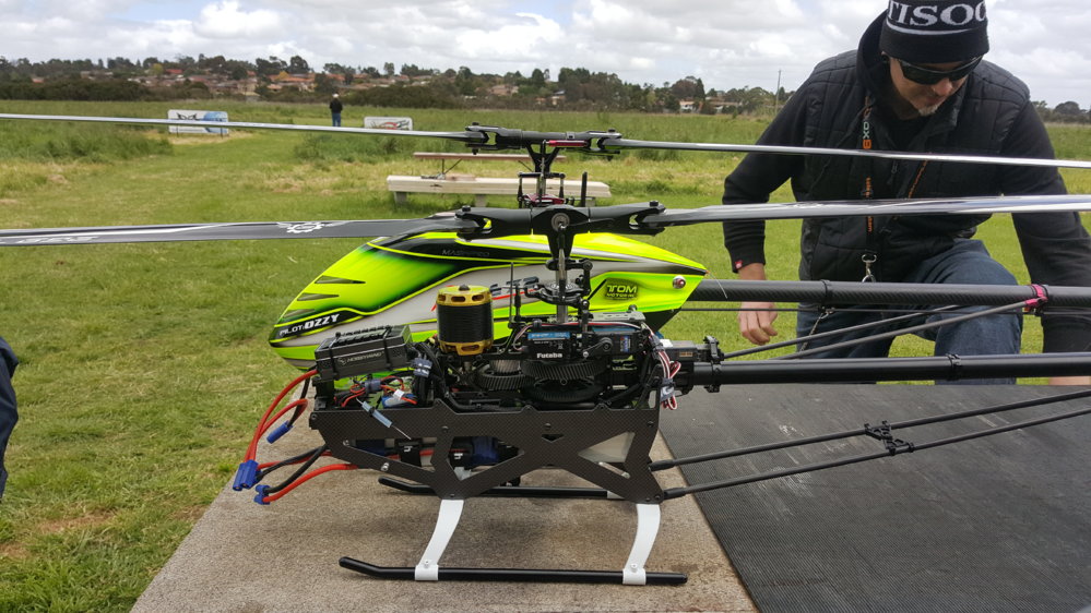

    It looks like it borrows a lot from other models.. it has the tray and nose of an align.. the lower frames and boom/tail of a raptor. The centre part seems very goblinish, and the head reminds me of a Gaui. Everything seems as close as possible to the main shaft, trying to get CG as close to the centre point. The head looks great, and the heli seems short... here is a pick of it in front of an Agile 7.2
    One of the main things it does different is the tail push rod, or in its case.,. a Torque Tube, for lack of a better word. This just bolts onto the servo and turns.. no pushing.. this gives is pretty much 0 mechanical gain, and in fact, it is the highest I have ever had the tail gain on a brain because of this. However the tail was very tight, the links causing the stiffness. This created a wag for the first flight.. but I let it go, oiled the tail shaft, and it loosed up by the end of the flight, to where there was no tail wag on the second flight.
    The other interesting note, is that it has only 1 swash follower arm. I hear that this is to save weight, but from the design I am not sure. It does however by make that one arm super stiff, and I would not be surprised if has less movement than the standard design, as the arm is supported on both sides..
    I also love how the canopy has no external visible signs of how it is mounted... this could make repairing the canopy after a crash harder, but I love the way you can see no canopy mounts.
    Flight
    well I have only had a few, and in windy conditions so it is hard to tell. The heli seems very aggressive off centre, both in cyclic and tail, I will end up tuning this down.. only a little... it however moves in the air, and with only 696 main blades. I am keen to try some 716's on it, and see how it goes. Running either 4400's or 5000's doesn't seem to make a large different like it can on some models... but I will continue testing and see..
    Overall
    Its a nice quality heli. Except for the tail control there is nothing super innovative about it.. but then again, no brand makes large innovative changes on a regular basis. It flies well, but I have yet to tune and really give it a go, so keeping my opinions to myself on that one for now...
    Overall its a very nice heli, that I am looking forward to see how it goes once she and I have become friends...
