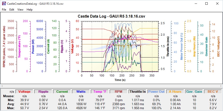

      Here is a Castle log from a 3.5 minute speed flight that makes this R5 go for those of you that like this kind of stuff.

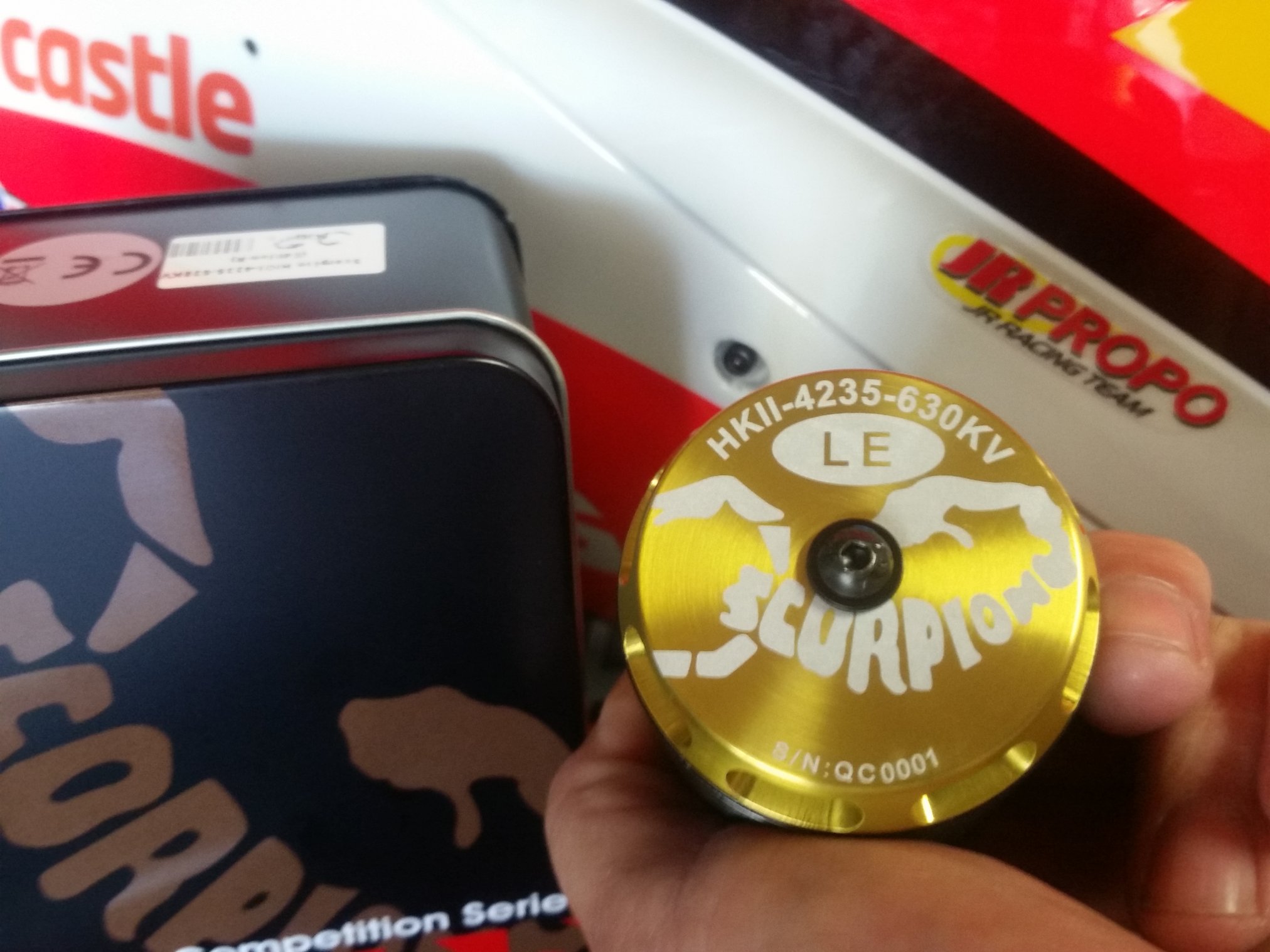

      It's time to make her go faster with the new release Scorpion 4235 630 KV motor.
      Wow, here are the motor specs!!!
      Stator Diameter 42 mm (1.65 in)
      Stator Thickness 35 mm (1.38 in)
      No. of Stator Arms 12
      No. of Stator Poles 10
      Motor Wind 4 Turn YY
      Motor Wire 1-Strand 1.6 mm
      Motor Kv 630 KV RPM/Volt
      No-Load Current (Io/10V) 3.59 Amps
      Motor Resistance (RM) 0.009 Ohms
      Max Continuous Current 120 Amps
      Max Continuous Power 5328 Watts
      Weight 522 Grams (18.27 oz)
      Outside Diameter 52.3 mm (2.06 in)
      Shaft Diameter 5.98 mm (0.24 in)
      Body Length 64.5 mm (2.54 in)
      Overall Shaft Length 112.9 mm (4.44 in)
      Max Lipo Cell 12s
      Max Peak Current 160 Amps (3 seconds)
      Max Peak Power 7100 Watts (3 seconds)
      Motor Timing 5deg to 15 deg
      Drive Frequency 8kHz
      If you dont mind me asking, what speedy are you using in this beasty? This motor will peak at 160 AMPS for three seconds according to the specs.. seems almost like you need a 200amp to be sure?
      I know a 120HV castle can peak at 160+ on the logs..

      I'm spinning 3250 HS and only pulling 129 amps Max. I'm using a Castle 120 EDGE HV ESC with an added fan to keep it cool.
