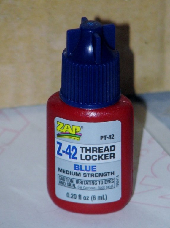

      Oh yes! We have the locktite brand here, as well as a couple of generic brands. Like Zap Z-42 Blue. I have a couple bottles of the blue Locktite brand and the Zap brand in my toolbox. They both work about the same, but the Zap is a little cheaper.
