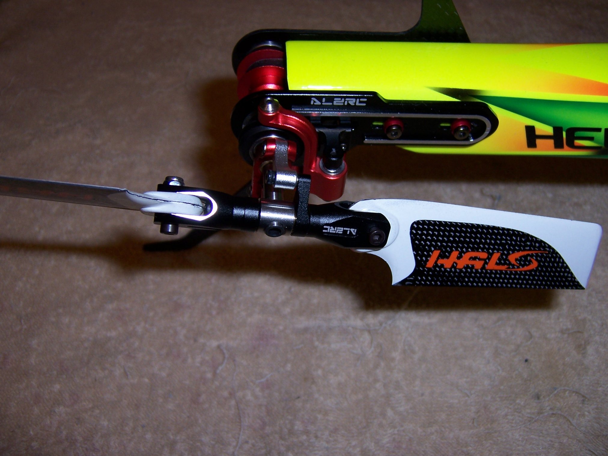

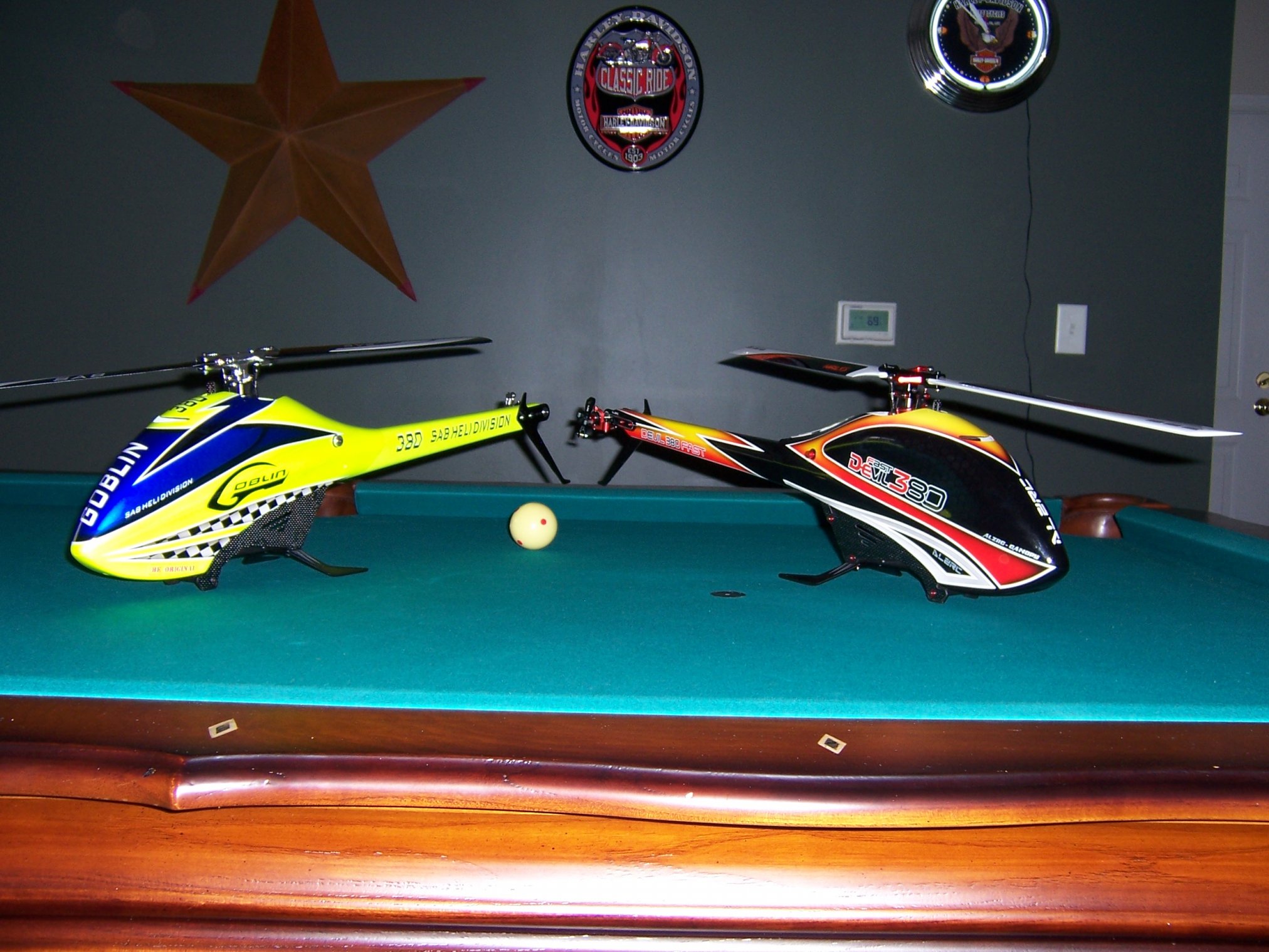

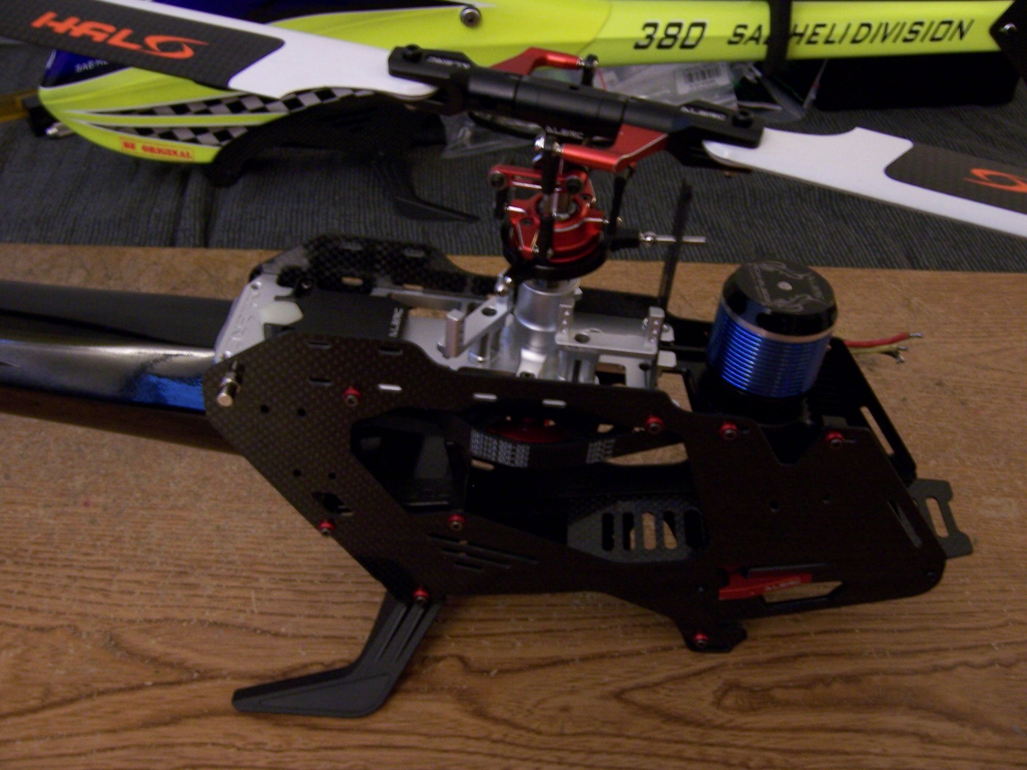

      000_0678.jpg 000_0651.jpg 000_0650.jpg ALZRC keeps saying they will be raising the price not dropping it. The FU-Bar has been good and solid. I just finish installing the G380 tail shaft / hub on Devil. I did not see anything wrong with the Devil tail hub.

      I had a chance to compare G380 and Devil head parts today. The Devil arms have a tighter tolerance with grips than the G380. The Devil arms will work on either grips.
      The G380 arms fit the Devil grips the same way they fit the G380 grips. The G380 arms have a bigger tolerance( more play ) fit with grips. They have the same play on either the Devil or G380 grips. So since the play is the same they should work on either grips.
      All the measurements between heads are the same. The Devil hard dampeners(3.78mm) are slightly smaller than the G380(3.80mm) ones. The Devil kits come with a smaller o-ring installed but they supply the thicker o-ring.
      The two main shafts I have on hand are the same length. The spindles are the same length.
