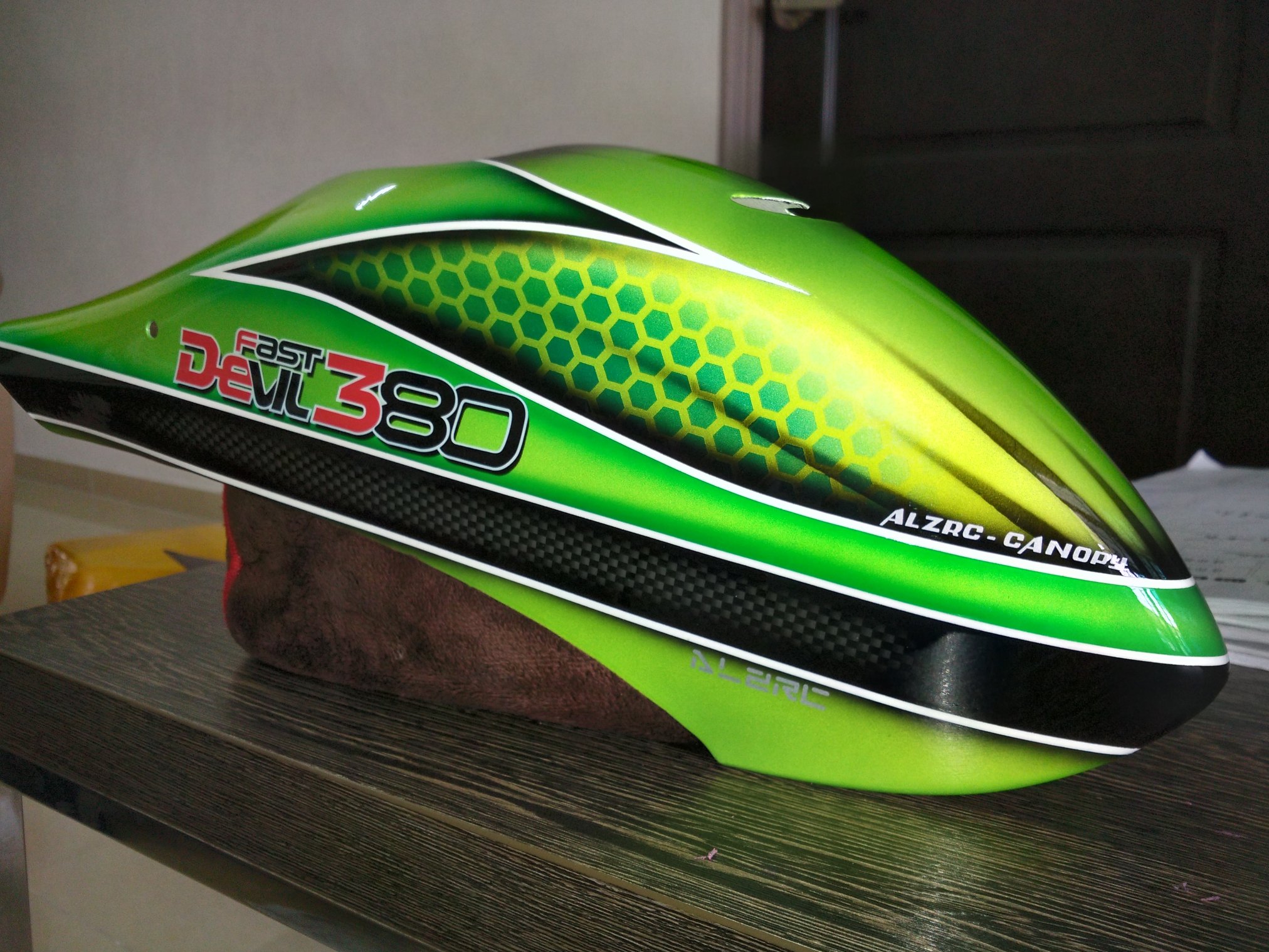

      First off, no complaints about the canopy...colour I like and some impressive graphics and painting here. Really awesome in person and in the sun.

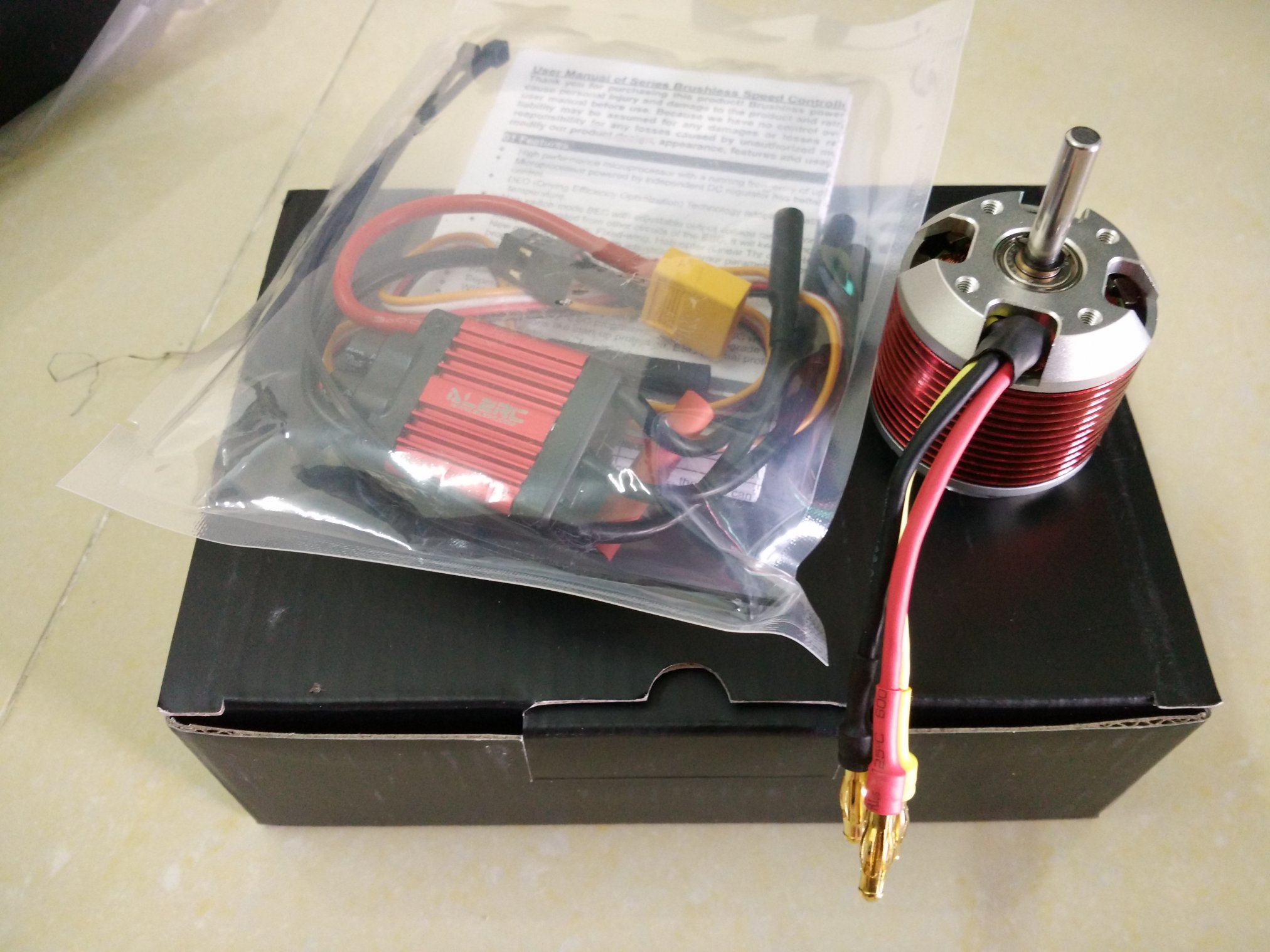

      I got the standard combo that comes with the motor and esc, so it's a 1000kv 6s motor nothing special about it but nice visually nice windings, nice bearings and nice bell. Also comes with a rebranded Alzrc HW platinum pro V4 60A esc. And it's good that it comes with all the motor and esc connectors, XT60 on the batt and 4mm bullets on the motor.

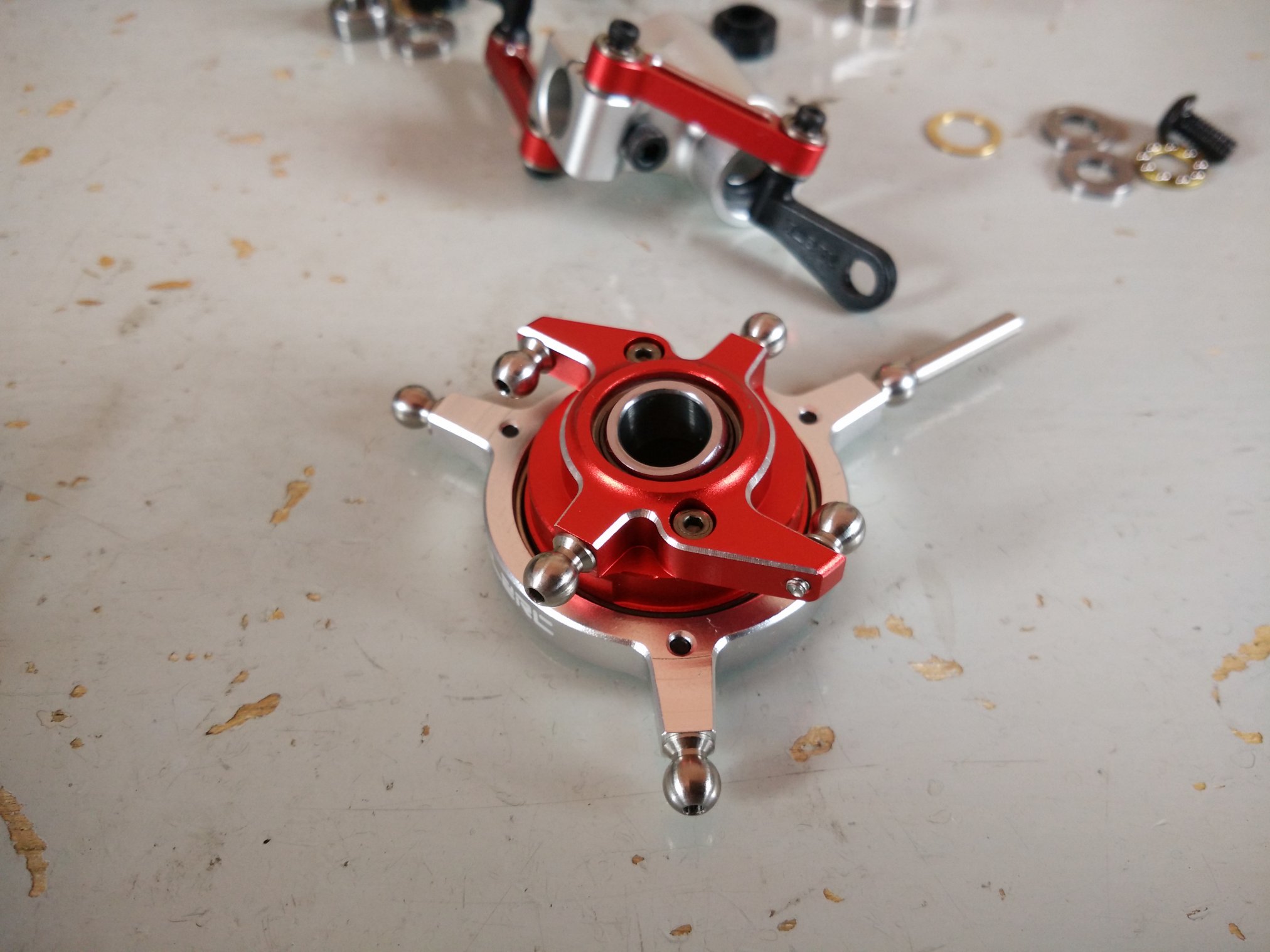

      No bearing play in the swash and great looking tail sliders.

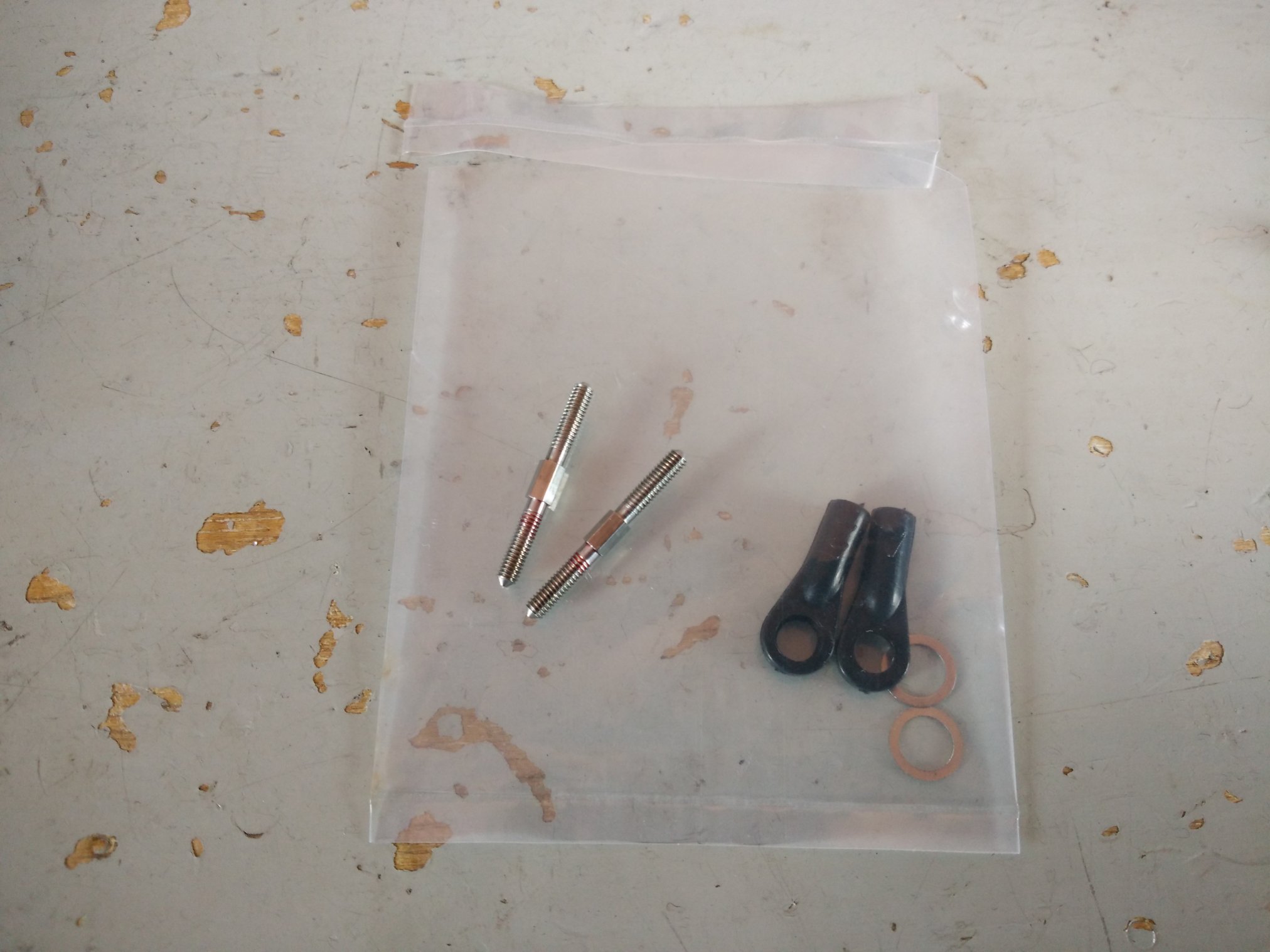

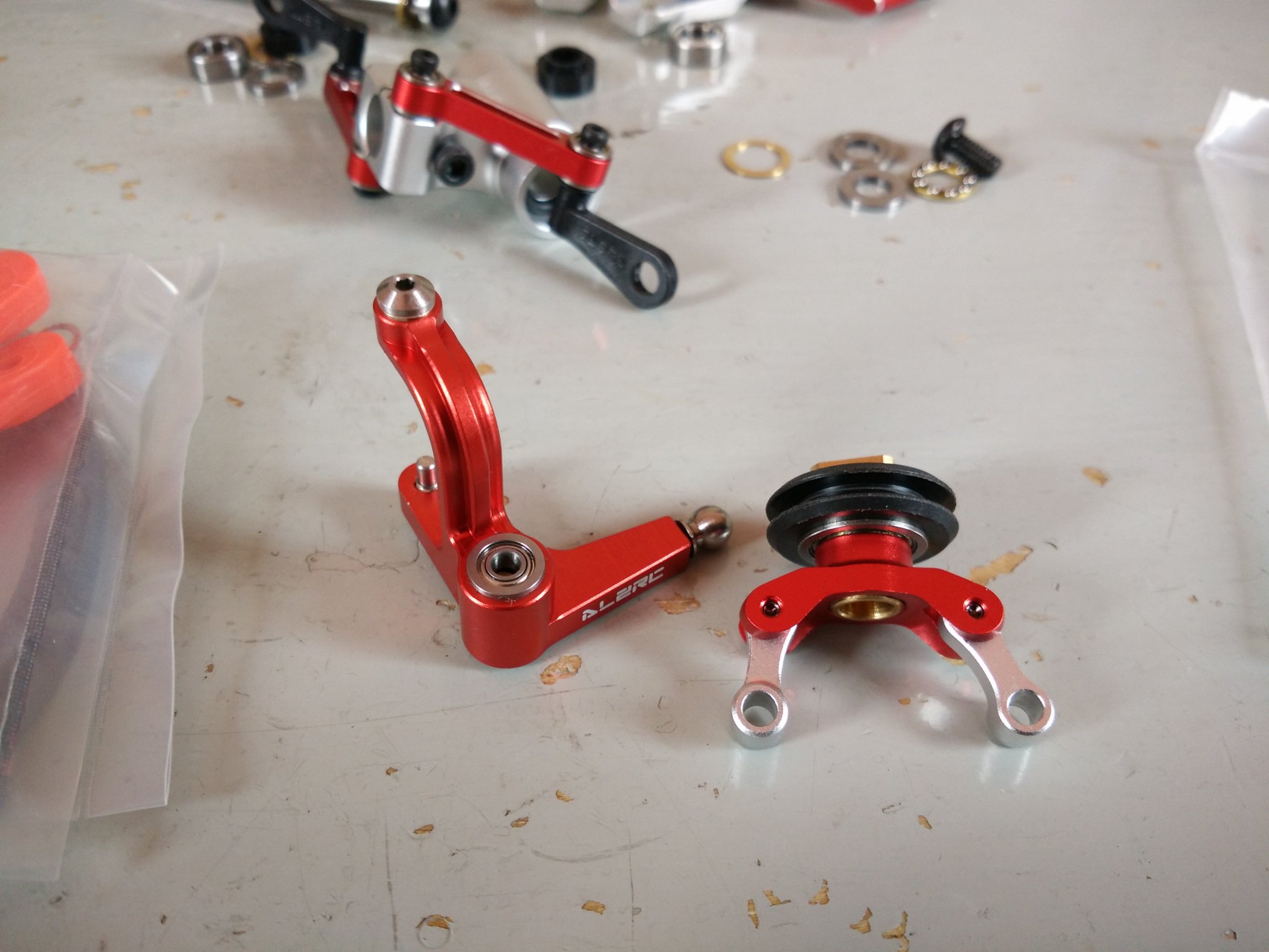

      Going through the stuff, this was when the first thing went wrong...it was missing a set of swash to head ball links. There was just 2 in the bag when I needed 4 to complete the links. Measured the swash balls and seem they're just slightly bigger than the Align ones I've on hand. Just slightly loose, it could work ok but I might probably just swap the links from the tail over and do everything Align on the tail. No idea what those shims are for, maybe for adjusting head dampeners?

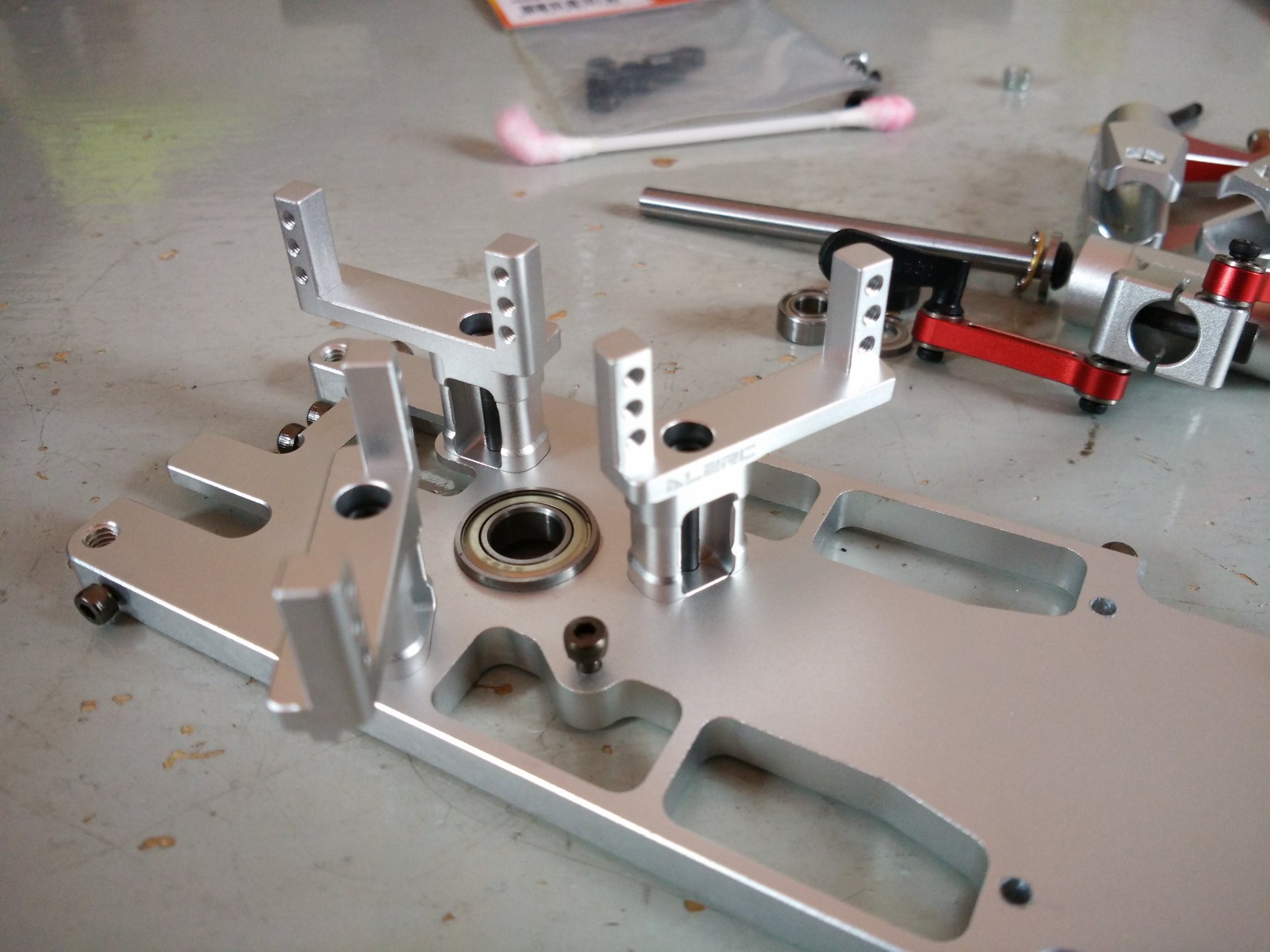

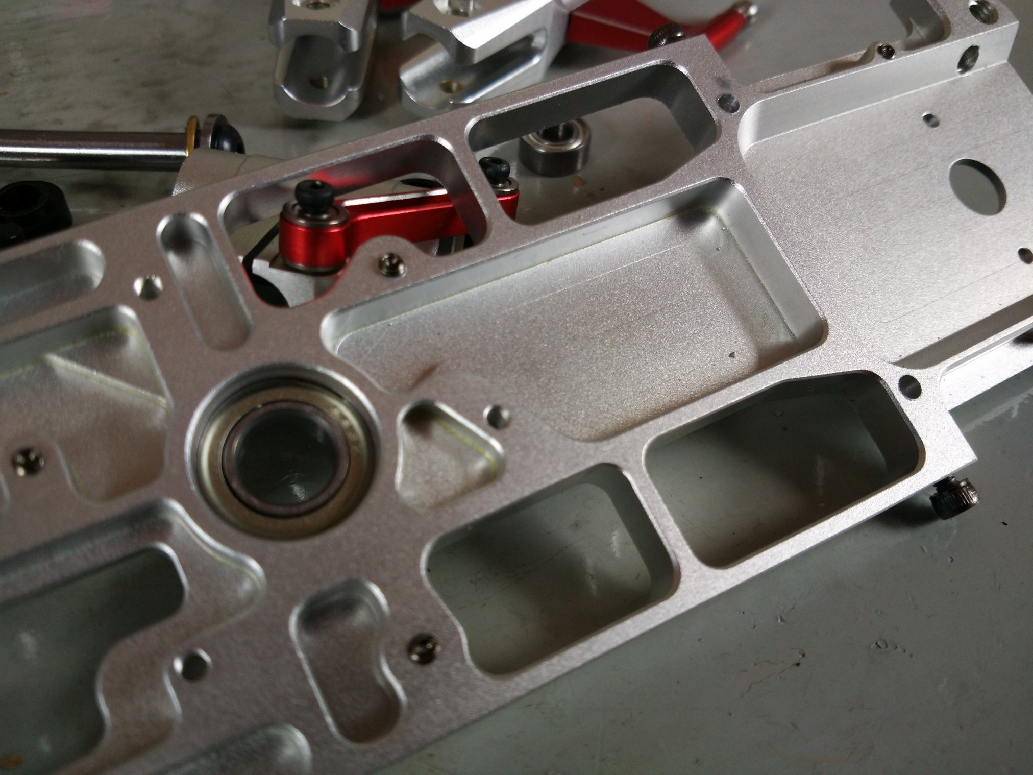

      There was some comments in other forums doubting that the main plate was CNCed but I can see the cnc milling marks but they've anodized or painted it over. And there're also chamfers on the edges and the finish is very nice indeed.
      Also like the aluminium servo holders, some might say it's unnessary added weight but for most won't even notice. Very nice and tight fit in the main plate and a fully shouldered 2.5mm bolt to hold it in place. IMG_20160421_141112.jpg

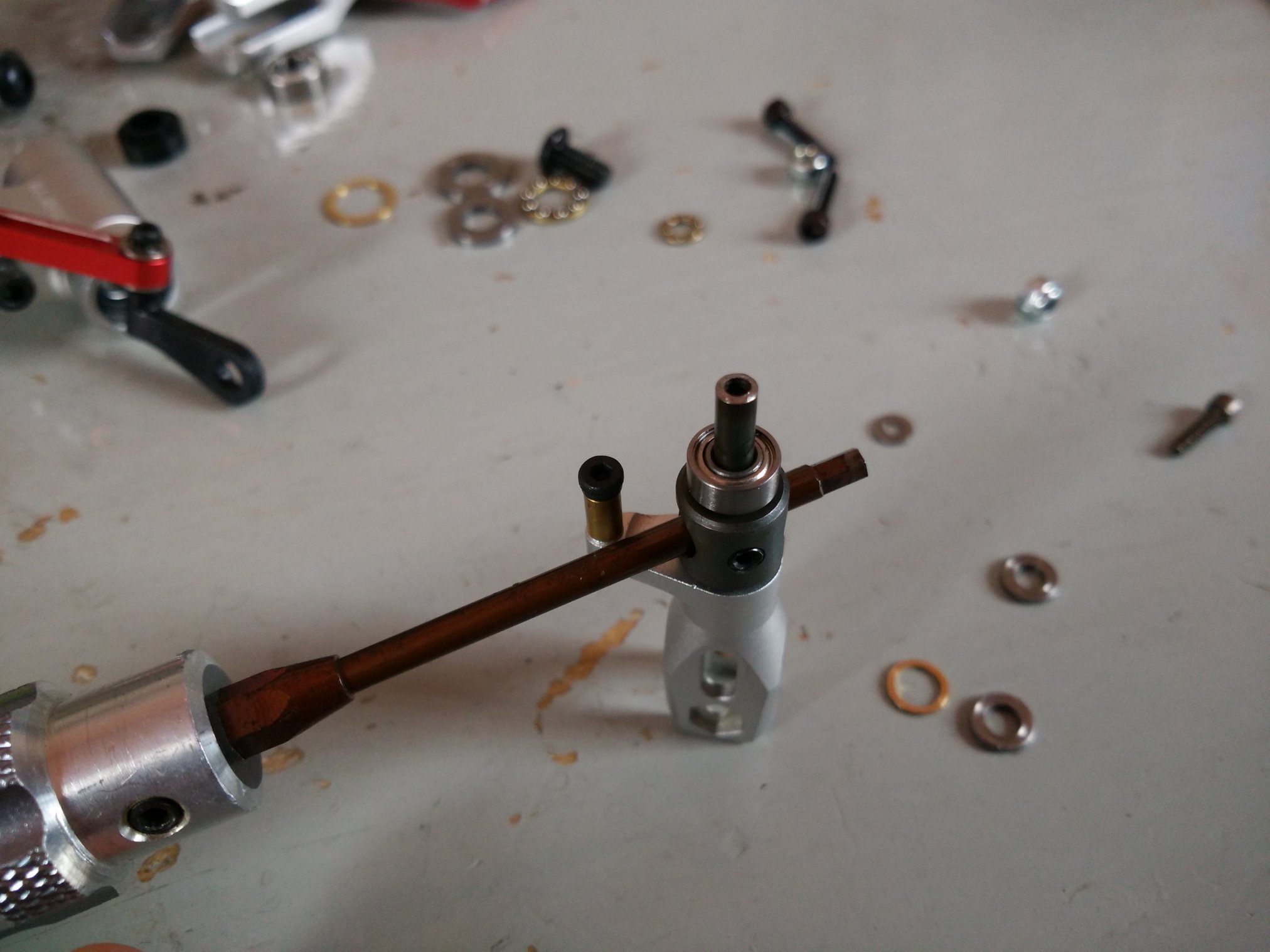

      And now for the worse thing about this kit, off all the things when the cloned the G380 they opted to not clone the G380 single shafted tail hub and instead went with the old tech tail with the solid hub. Even though Alzrc came out with the bigger tail blade grips that would accept tail blades with 500 sized roots, they crapped out and stayed with 3mm thrust bearings and a small 2mm bolt at the end. When I went over mine I was shocked to see what looks like they cut the hub ends off with a crude Dremel grinder. Not sure what happened here but definetely not something you'd see new in the box. I tried tightening down the blade grips and lucklily nothings binding and no slop in the bearings.

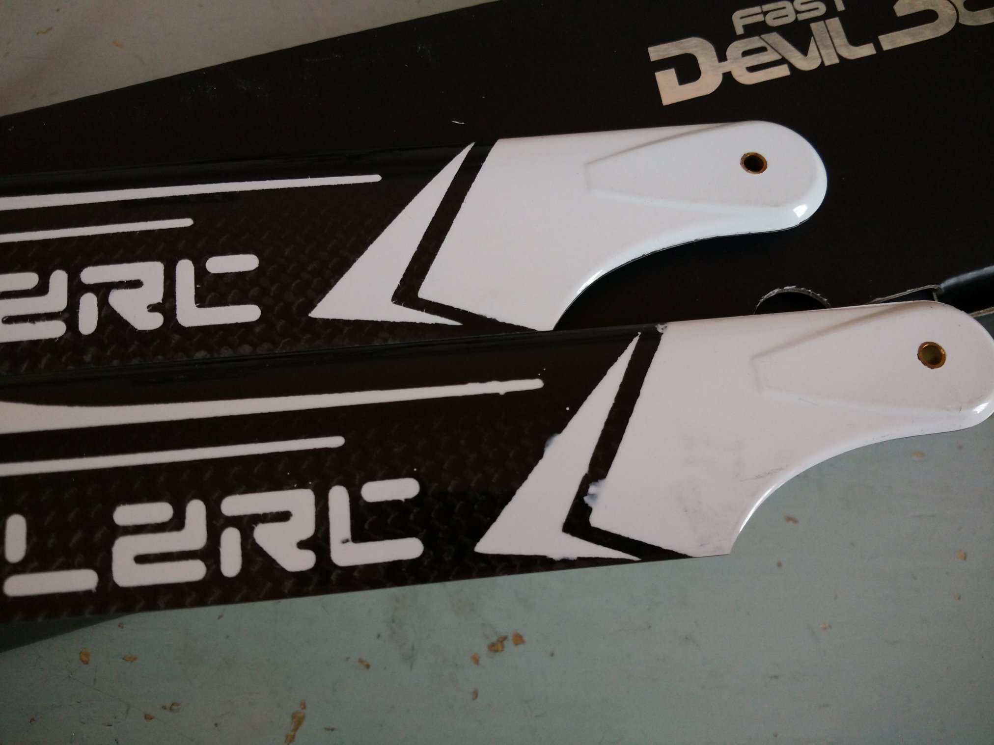

      And lastly the blades came with lousy paint job, carbon fibre blades and probably works ok but need to put them on the balance and see if they're out by much. IMG_20160421_143048.jpg

      Well lots here hate clone stuff in general but this comes with some pretty nice cnc parts. The carbon frames are top grade too, very rigid 1.6mm thick n no burr cuts. Maybe this would make good replacement parts for some G380 flyers.

      Still not tried balancing them yet, will get it done maybe tonight. And the dreaded orange coloured tail blades too, yuckkk!
    17. smakmeharder
      There are a few blades to pick from now. Top level blades are pricy - around 50-60 but there are some zeals (which i have not tried) which are significantly cheaper. Do you have a blade balancer?
