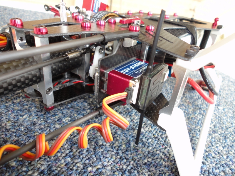

      I was going to take the other option and mount the tail servo at the front.. Any thoughts?.
    8. jockstrap
      looks tight up front for the tail servo.. I'd mount a bigger one up back - easier to work on and I'm always a fan of mid size not micro for tail servos.. even on a 450..

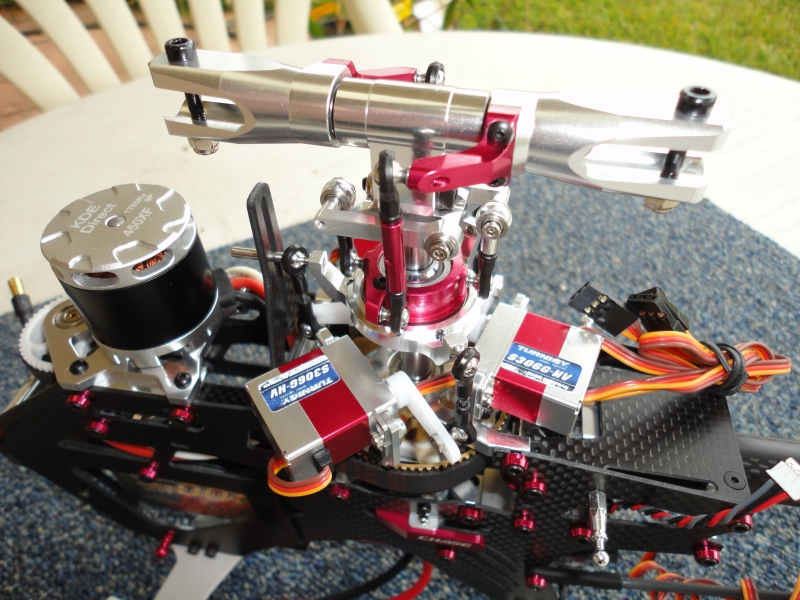

    9. jockstrap

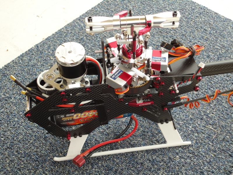

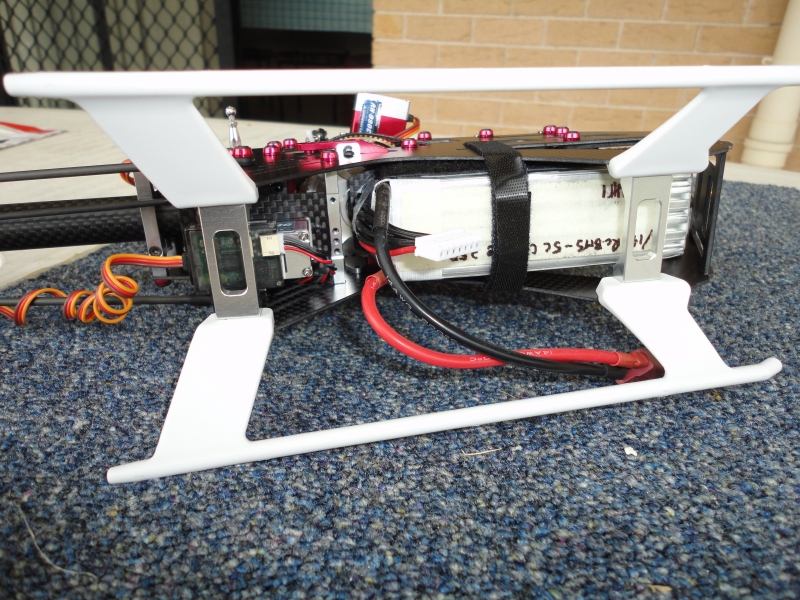

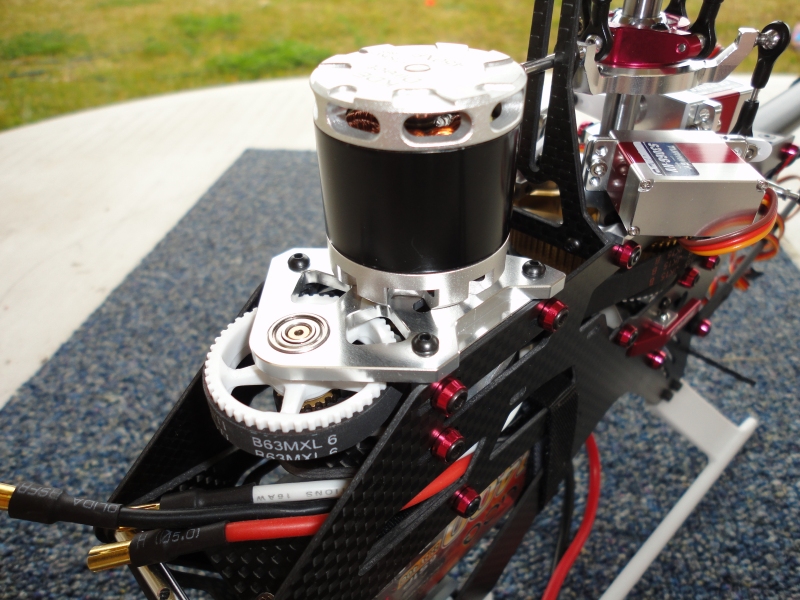

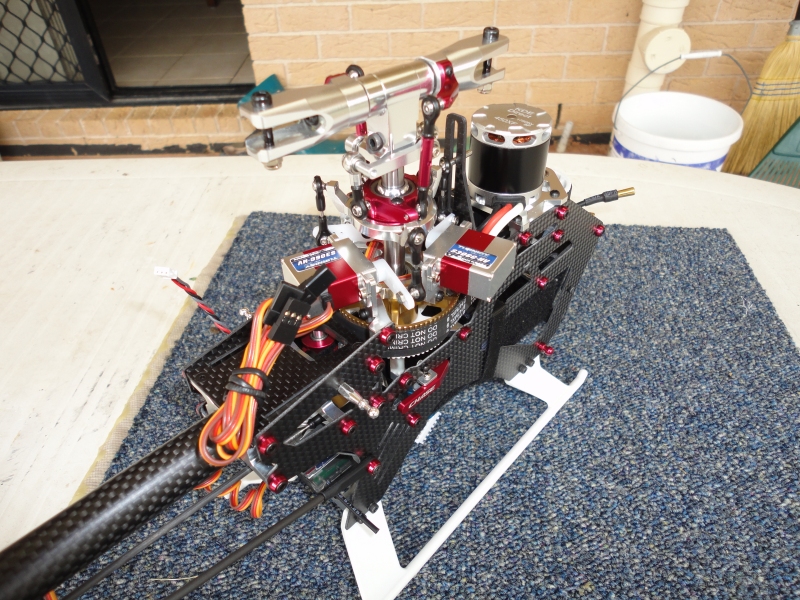

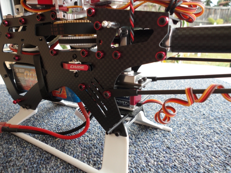

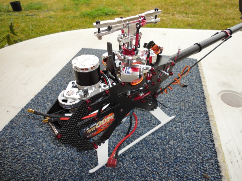

      Here are some pics so far - still needs esc and fbl units mounted...
      In this first pic, you can see the front boom support tightening screw abscured by the servo - flip the boom mount around and have the screw on the right side and you'll be able to reach it with tail servo installed.

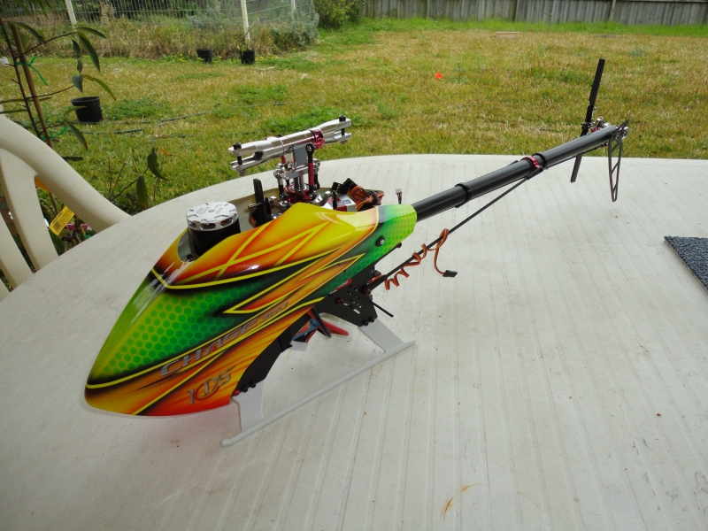

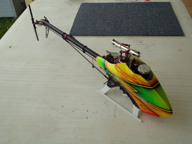

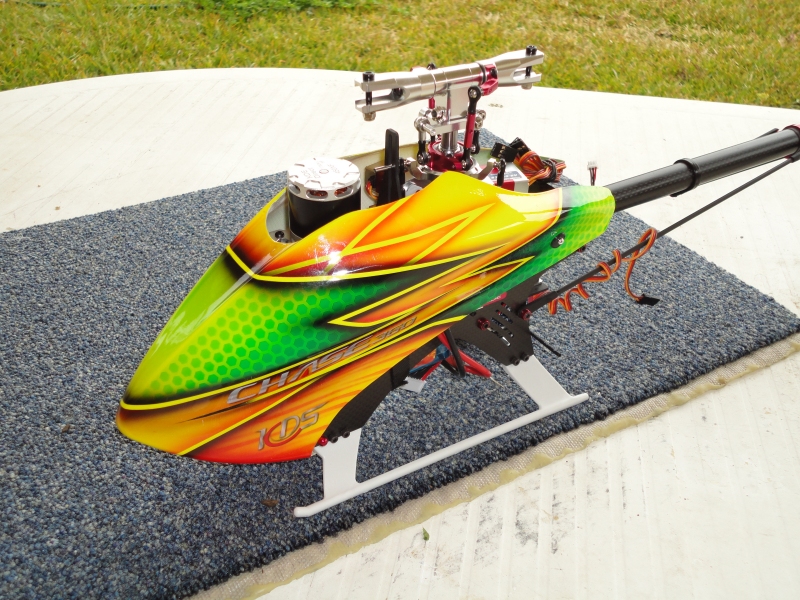

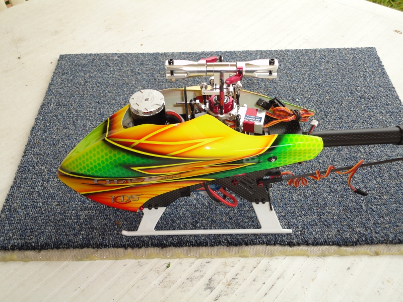

      And some more with the canopy on...

      My combo kit came with the small tail servo,should do the job though..?
    12. jockstrap
      Of course it will... if it came with the combo then it will be up to scratch..
      Just my personal pref for a larger one..
      However, I'd put more stress on the tail at the moment than you would so it will be totally fine for you...
      It may be a little harder to access that's all but it seems like it should be ok... will still come out with 4 screws like the back mount so no deal really...
      Like I said - just personal pref... the heli was designed with the small one to bring CG forward a little and higher so if anything. technically the heli should fly better with the small servo..

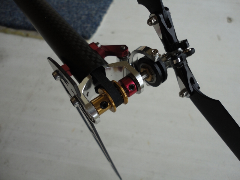

      Had a test hover of mine in the back yard today...
      Hmmmmm - not so good...
      Seems something wrong with my tail - maybe the hub bent as my tail wobbles side-to-side a little :(
      Like tracking in main blades but in tail - so causing some tail vibes... but not heaps but enough to annoy me and to be of concern...
      I pulled the tail apart - all looks good. can only think the hub is not straight as shaft looks straight and grips, bearings, look all ok..
      also - on my stock 450 vbar settings which always "just work" for virtually every 450-500 i've used vbar on were causing bad tail gain wags and also cyclic wobbles when flicking the collective..
      I can't beleive it - tail gain on my DX7 is down from 46 (normalish) to 30 and cyclic on the vbar is as low as it can go (40 - normally about 65) and it still has a slight wobble when flicking collective sticks :(
      I took it inside and changed the cyclic ball links in one hole on the servo arms to give more resolution - now sits around 80% to get 13deg collective pitch whereas it was down around 60% (red zone) before.. now a little better but as i said - still bobbles a bit on quick stops but i'm at the lowest vbar gain it will go :(
      Cyclic is still fairly crisp so not too low in gain ???
      anyway - going for major maiden tomorrow - wish me luck..

      Oh no mate that sucks! It really gets on my nerves when there are issues on a fresh build too.. its happened to me before.. :(
      How would the tail hub be bent?! o_O Maybe if its waggin' its your gain??
