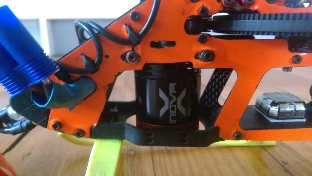

    Fitting one to a Mini P , VERY small frame mod needed, Just over 1 mm, needs to be shaved off to fit it up snug in the frame where the motor hits the frame just below where you tighten up the motor bracket, A very small mod that would have no effect frame strength at all. So small infact that a few strokes of a flat file is all that's needed, Don't let that put you off for a second ! The other good thing is they are available with a shaft already fitted to suit the mini P (Diagram B , Below) :)

      did you have to do any mods to fit the motor in or any issues?

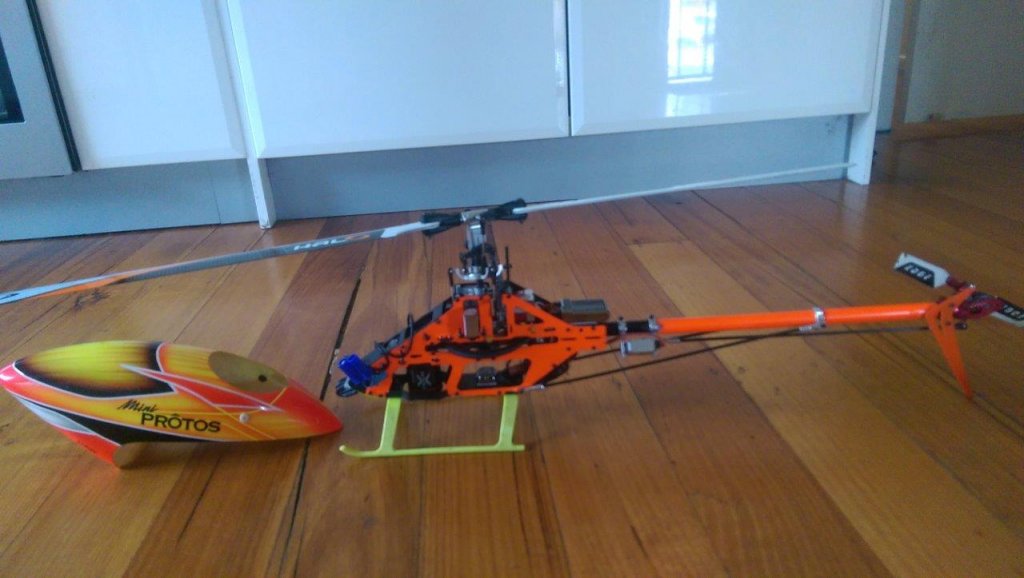

      Easy mod.. Takes a couple of minutes to file a tiny indent just below the motor support tray. I will upload a photo for you.
    13. Manyc
      You know I'm swiping that pack to use... You know that right.... :p
      Okay here we go.... @Finky. These are some shots of my Mini P... Note the slot just under the motor mount. This allows the can to fit. very easy mod.

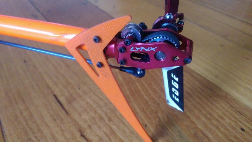

      Sigh... I now have one of these beauties... not sure when I'll be able to get it in...
    20. feral
      Lol arsehats.
      Does it look like this 1?
