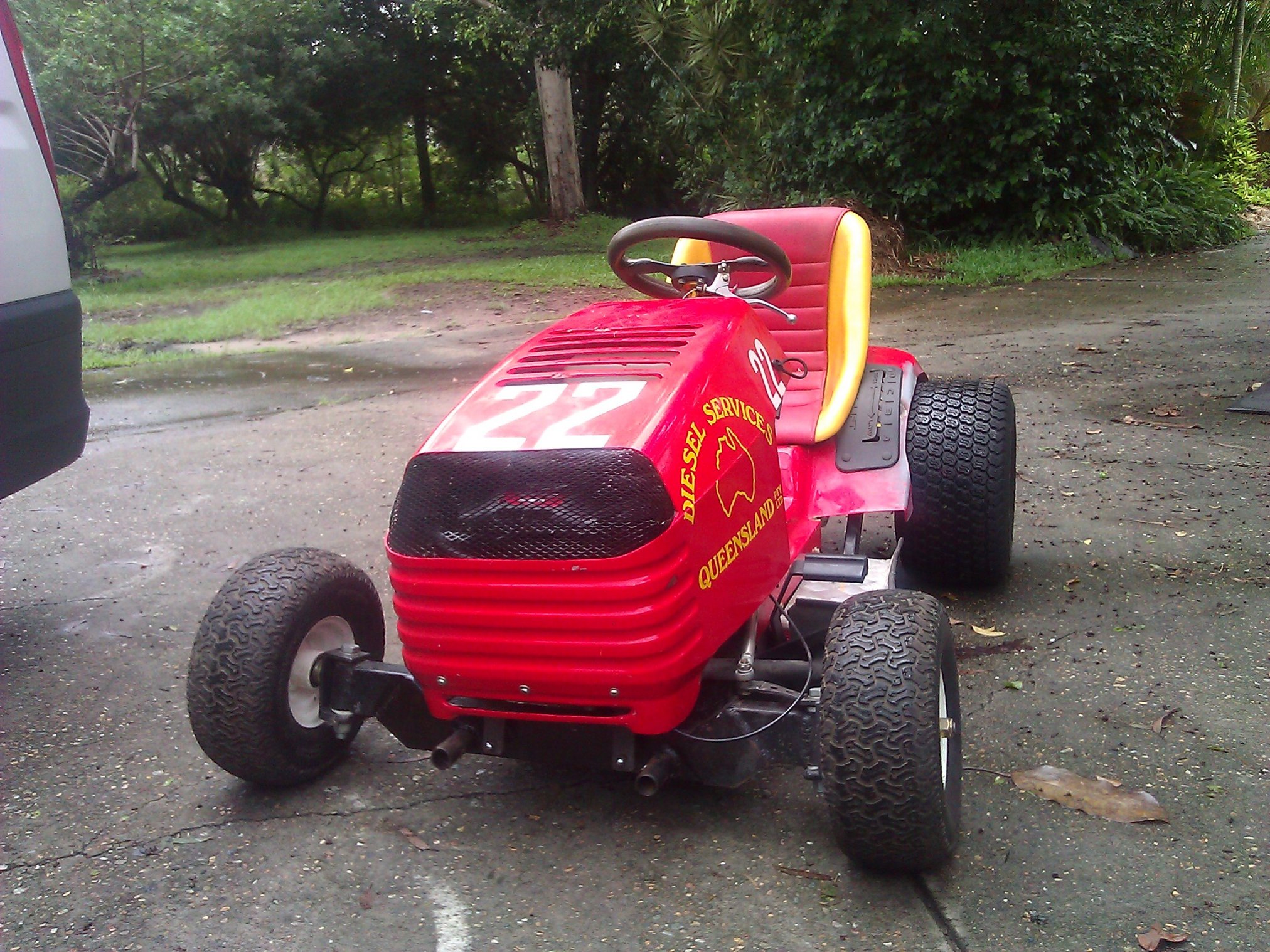

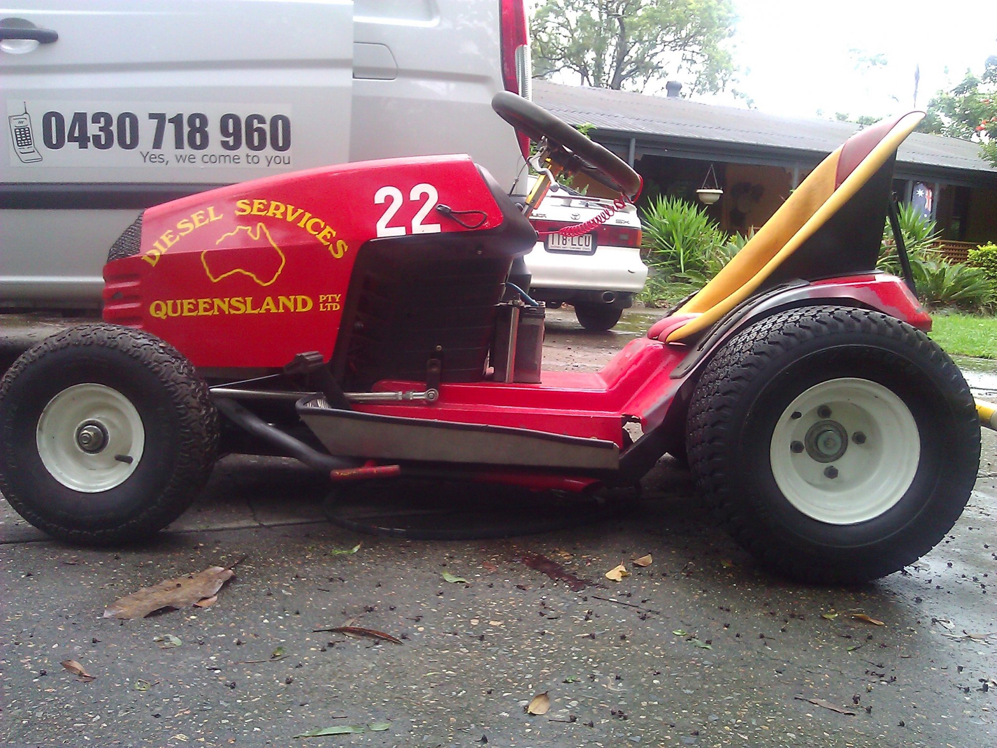

      Definitely good fun that. I ran, organized and sponsored the first Mower race here on the Gold Coast about 6 years ago. We had a lot of interest and guys and girls came from all over the State. We probably had around 20 teams turn up.

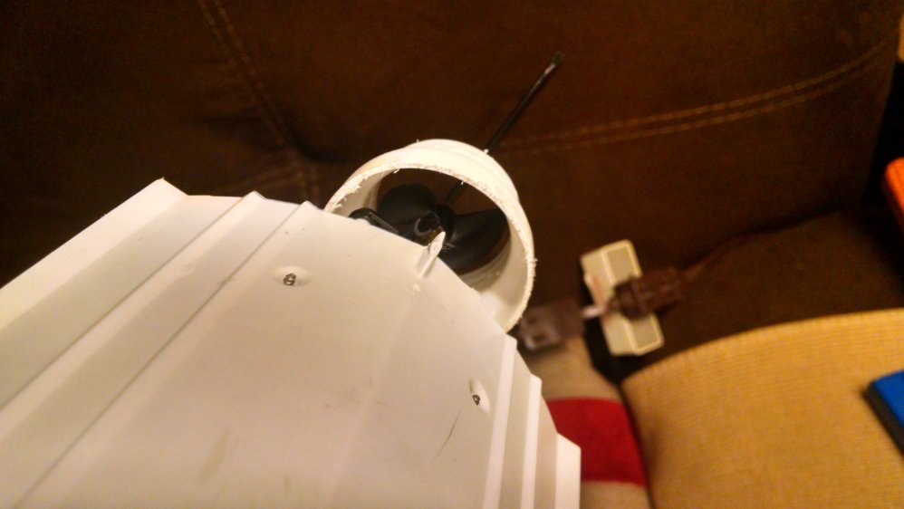

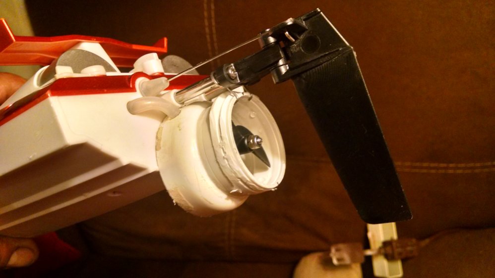

      You know me..... I can't leave well enough alone. I fabricated a makeshift "jet pump housing" for the prop after noticing the straight prop-shaft out of the stern doesn't fully submerge the prop, so I figured, why not try to guide the water up around the prop?
      So far, it seems to working. There is some slight cavitation at extreme slow speed, but once it gets moving just a bit and starts scooping up water, it takes off like a shot! The original idea was to even out the turning ability, because the side thrust of the prop half submerged made for great right turns, but left radius was Shiz. The duct work seems to have improved on that as well. IMG_20160725_210430785_HDR.jpg IMG_20160725_210444326_HDR.jpg ..... it's the top section of a plastic Tylenol bottle. :D
